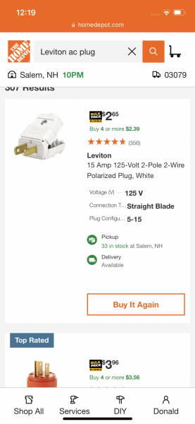

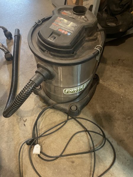

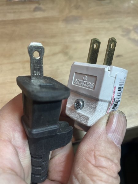

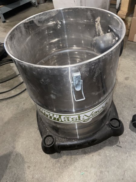

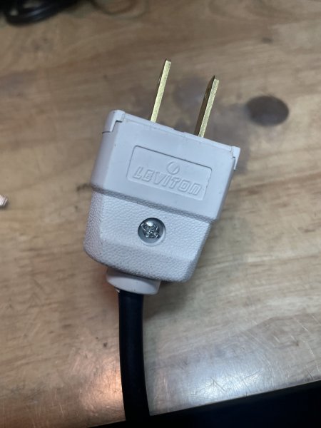

    One of the prongs on the power plug broke and the motor finally wore out. A new Leviton replacement plug and a new top motor head and bingo! Works like brand new!!

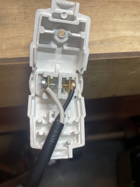

    Is it white neutral color AC wire to the silver screw on the left in the pic which is connected to the wide prong on the plug ??
    Pic 1 - new Leviton AC plug

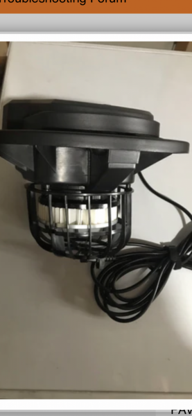

    Pic 2 - New top head with new motor and secondary white motor filter.
    Pic 3 - Old broken black molded plug vs new white plug
    Pic 4 - Wire hookup
    Pic 5 - plug is fixed

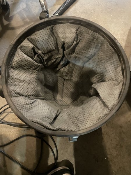

    Pic 6 - vac is fixed
    Pic 7 - new bag filter

    Yes I had the one of those. It lasted quite a while but the motor burned out. The new model has a secondary round white filter to protect the motor and it lasts a lot longer. :) I clean this filter with my compressor and it lasts long also. :)
