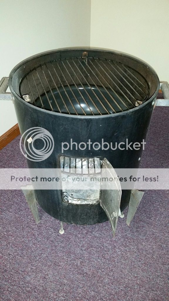

    Here are the pics and my mods for the Brinkmann Smoke N Grill.
    First thing is to assemble the unit with the legs on the outside and drill a 1/4 inch hole in the body and one in the lid- you can see positioning of those left of the door and factory thermometer (which is crap). Those holes are for inserting cork stoppers that hold real thermometers (mine is a Weber grill thermometer purchased from HDepot. Drill the corks then insert the thermometer shaft). You can see the new legs on the charcoal pan in this pic as well.
    Then you can see how the water pan sits on the lower grate and how it all goes together here...

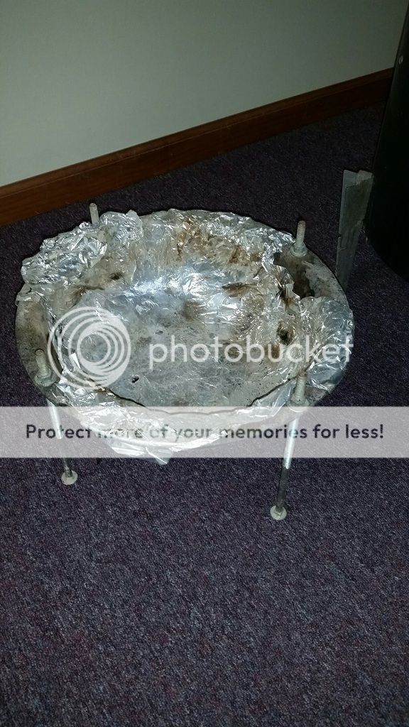

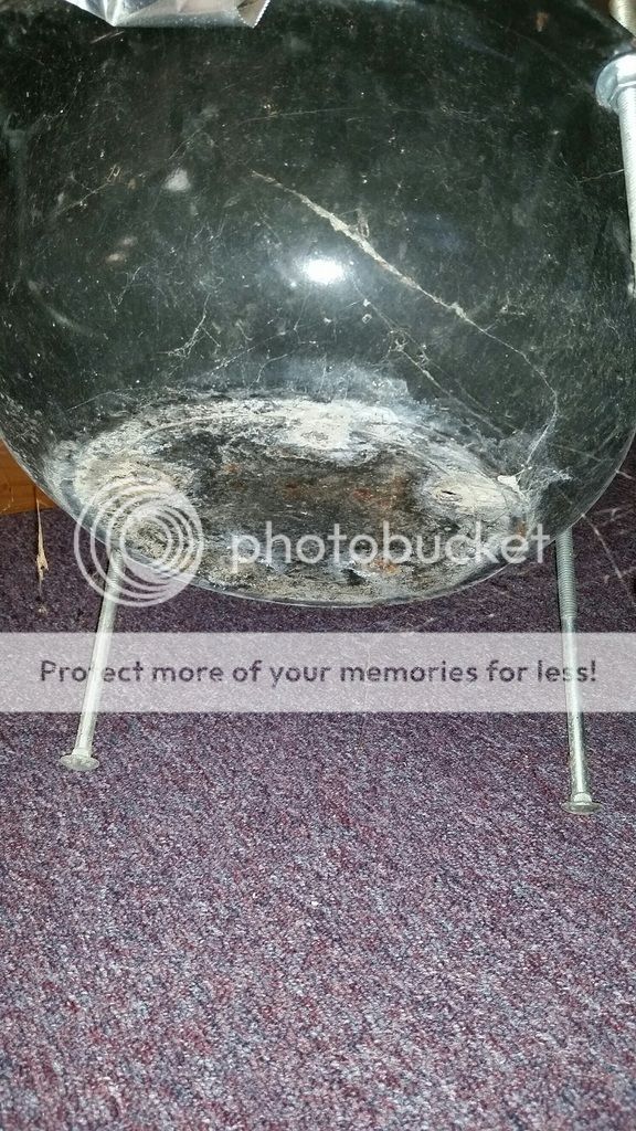

    Then for the charcoal pan, you will need four 5/16 inch carriage bolts about 14 inches long, 8 washers and 8 nuts. Mark, punch and drill holes for the leg bolts in the lip of the pan. Install bolts for the support legs. Then mark, punch and drill 5 1/2 inch holes in the bottom of the charcoal pan, near the outer edge of the bottom, for air vents. Line the charcoal pan with two sheets of HD aluminum foil, punch holes the foil at the new vent hole locations. Do not use this on a deck, as hot embers will be coming from those new holes.
    You will need a large stick to stir/stoke the charcoal when reloading and an special made heavy duty coat hanger 'L' to poke/auge out the coal bed up through the vent holes about every two hours. Always reload with a hot load of charcoal from a chimney, by lifting up the whole body and lid off the charcoal pan - about every three to four hours. You refill the water pan through the hinged door, via long neck beer bottles. It helps cleanup to spray that whole water pan with PAM prior to starting to cook.

    That's a cool mod/set up. Thanks for posting the pics and explaining what you did with it
