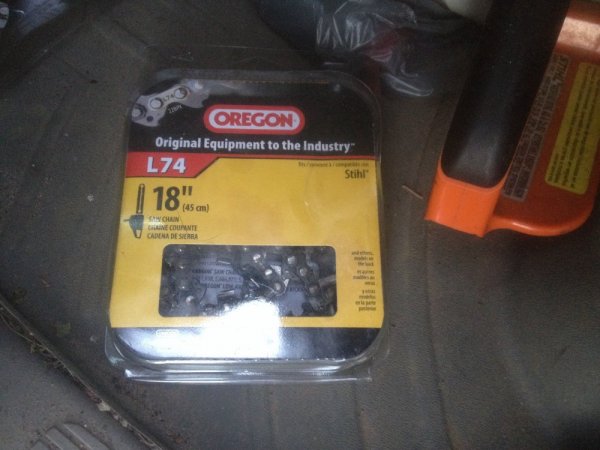

    For the MS290? Yes. if it's .325 chain you need .063" 74DL. If it's 3/8" chain you most likely need .050" 66DL.
    This assumes you have a Stihl bar on the saw.

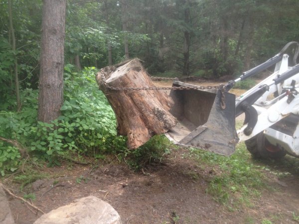

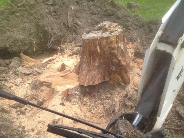

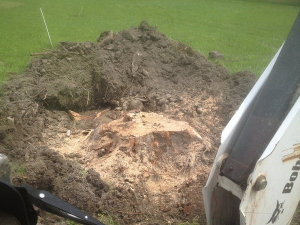

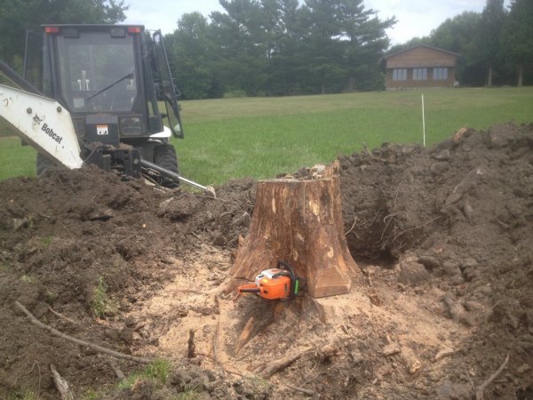

    Picked up two. Found the chart with help. LOL Guys, I needed a bigger saw! The Elm stump at bottom of hill. It's hot out, and this was a bear!!!!

    As long as the pitch, gauge, and drive links are the same? You can use any chain.
    .375 x .050 x 66 drive links (18" Stihl Chain or Husqvarna is 68 drive links)

    It's below grade now! That stump cost me so much sweat...... I decided to bring it home so I can burn it in the boiler late next winter. I ended up with two Oregon's.

    Glad you got it done Gas..... Even if you did have to buy a semi-chisel safety chain to get there..... :p

    I suppose, with me working the saw, safety chain is good. :rofl: :lol: They seem to cut nicely, the Elm was a bear though. And they still aren't designed to enjoy eating the dirt! I scraped the whole stump with the backhoe and my boot to clean it off best I could. Still ate some dirt.:zip:

    Nice set up with the bobcat and that will be some good wood to burn with. Dont feel bad, your not the only one that the chains confuse.
