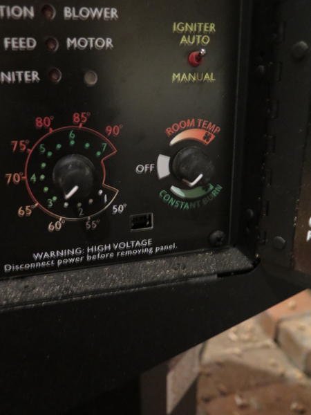

    My Honey calls me this morning and says that the p 43 is on wtf???:hair:
    She said that the power went out for a few mins. this morning could that be why it came on? Yes it is , when the stove runs out of pellets , you have to turn the dial to off and then back to on . I know that I pushed what ever pellets that were hung up in the corners of the hopper down to the bottom . So when the power went off then on and the dial was already in the on position and it had fuel to load it started . Mystery solved .
