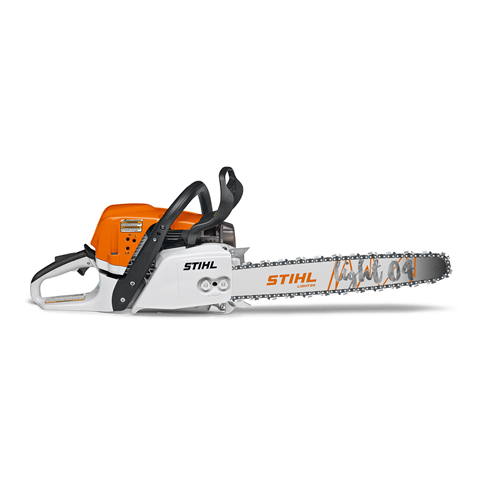

    The Stihl dealer is about 3 miles away from the house and I get a decent discount because of other business dealings.
    Looks like this might be the one with a 25" bar and a few extra chains. Just need to keep my fingers crossed they're not looking for a pro logging outfit.
    Our top-of-the-line chainsaw for farm and ranch.
    With an advanced low-emission engine technology, the STIHL MS 391 mid-range chainsaw improves fuel efficiency by up to 20% compared to previous models.
    MS 391 - $599.00
    With an advanced low-emission engine technology, the STIHL MS 391 mid-range chainsaw improves fuel efficiency by up to 20% compared to previous models. The new air filtration system requires fewer filter changes, allowing for longer run times. Improved fuel efficiency and fewer filter changes save you time and money.
