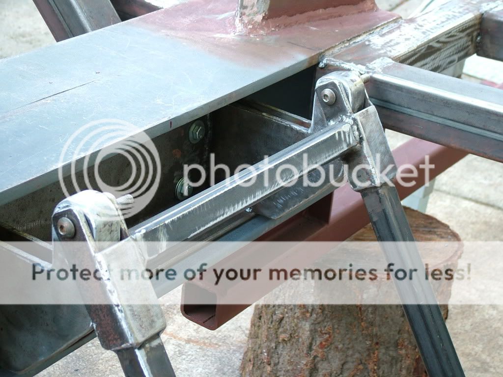

    Who has one ? I would like to make one on the beam of my splitter but I want to see how all of you anchored yours. Mine will be diy.

    Thanks guys but your right Brian I am looking to finish fabbing side beam lift. I need some hinge ideas more than anything. I have rebar I was considering using as a hinge through a pipe ?

    Here's an assembly from a thread at Arborist:

    Jags' machine uses some heavy round stock (1"?) and two pillow block bearings to pivot the lift. Overkill for a winch lifted application for sure but bombproof and pretty easy to do in any case.

    From Jags thread at TOS:

    If you are planning on mounting the winch like it is in the "jag.jpg" photo, I would recommend you have a drop down support of some type to help support it from the ground.
