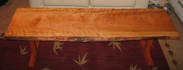

    I've done some live edge work both wood work and lumber. For a headboard, you don't really need a very thick slab 5/4 is plenty. Any hardwood will work and won't be too heavy. Anyways, once you get the headboard finished and either mounted to a bed frame or mounted to the wall, weight becomes irrelevant. FWIW, cherry, walnut and soft maple are less dense than oak or hard maple. I'm currently working on a queen bed with 6/4 x ~18" x ~68" black cherry head and foot boards and they are no problem weight wise. As far as finishing and bark goes, often the bark will partially or completely fall off in the kiln, depends on the species and time of year harvested. I generally would knock the rest of the bark off down to the cambium layer and then you never have to worry about it chipping off as in the picture below. As for finish, I always try to go with an oil-based natural color finish, usually boiled linseed oil +/- varnish (Watco, Waterlox, etc.). I think it give the most depth and I like the wetter look than I get with plain water based polyurethane or polyacrylic. The table below is finished with just varnish oil and it has held up to >10 yrs of spilled food and drink. If I ever want or need to refinish it, just wipe down with mineral spirits and steel wool. Then rub on a new finish. CT Top.jpg

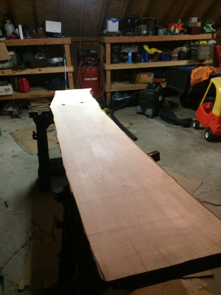

    IMG_0791.JPG Here is our slab of Norway maple. We payed 50 bucks for it so if I totally mess it up it won't be to much wasted. Started on it with my little palm sander. Gonna need some bigger guns. My bud says he has a belt sander I can borrow. If he can find it!

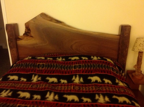

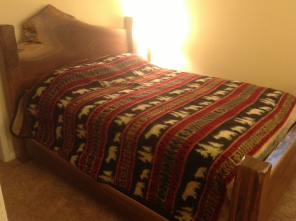

    I bought my headboard/baseboard/rails kiln dried with no bark. Two slabs actually, one for the headboard and baseboard and one for the rails.
    eatonpcat, Woodwidow, Warner and 4 others like this.
  16. Midwinter
    130,461
    Wow that headboard slab is stunning! What kind of wood is it?
    Horkn likes this.
  17. Fanatical1
    Fanatical1
    Feb 10, 2014
    2,681
    12,228

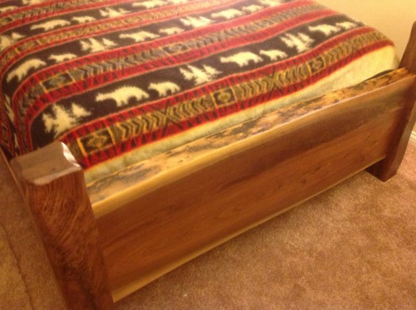

    Thanks for the kind words. It's all walnut. Headboard and footboard are from one 3" slab. Rails are another slab cut down the middle.
    Lots of good advice here, best of luck with your project, I'm sure it will look great!
    Horkn likes this.
  18. Boomstick
    Boomstick Banned
    Jun 1, 2016
    1,379
    4,616
    Saratoga county ny
    That's what I have planned, but king sized.
    Did you buy a hardware kit for the rails? So it's modular/movable?
    How did you assemble?
  19. Fanatical1
    Fanatical1
    Feb 10, 2014
    2,681
    12,228
    I had an Amish furniture maker I know do the assembly and finish. With that said, he used pocket screw joints for the headboard and footboard into the posts. And yes, it has bed frame brackets on the rails for assembly just like a standard bed. Two part catalyzed satin finish with no stain.
