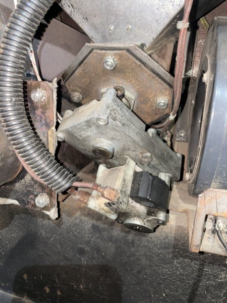

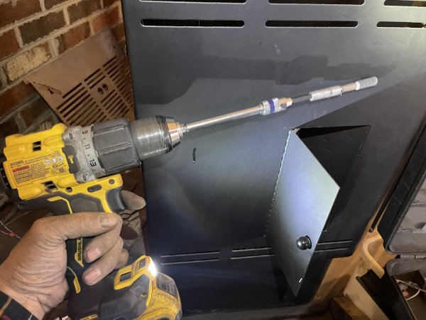

    The original igniter worked for about 7 years but the new igniters did not and this is the 3rd igniter in a little of 3 years! The stove is a smaller stove so the parts are all very close together in the back. Therefore to replace the igniter which has threads and unscrews, you must not only remove the auger motor but all the pellets so when you remove the auger end plate the pellets do not come pouring out around the auger shaft. Then the old igniter which blew the igniter fuse could be removed. This time with a flash light I peered into the igniter tube and could not believe what I saw! I had to take a good picture of it! It looked so strange at first I did not know what it was? I poked it with a screw driver and stuck in a test tube wire brush and could not budge it! Then I realized it was a metal burr. Probably a defect when the stove was made more than ten years ago!! So now what? I pulled out my bag of grinding stones and grabbed a mini cylinder shaped stone attached to a speed bit that I put on 2 extenders on my drill. Luckily it was small enough to get in there and drill. I did this carefully little by little and pulling it out to see any results. Finally after about a half dozen tries the burr was completely removed successfully!!

    Pic 1 - Igniter tube with metal burr inside!
    Pic 2 - Grinding stone and drill extensions

    Pic 5 - Auger motor re-installed
