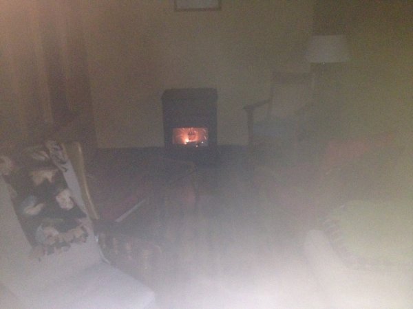

    First flame shared with you guys!
    This is first pellet stove I've owned.
    will711 and slvrblkk like this.

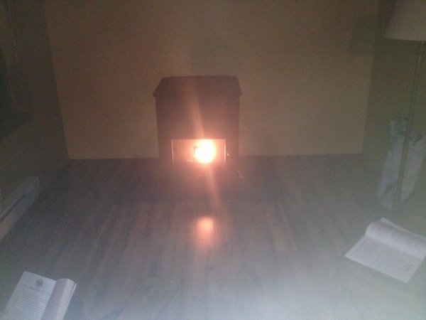

    It is a nice glow. I have it on 3 right now and it is throwing a good amount of heat.
