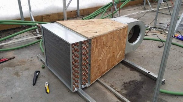

    Looking for some advice here.
    I have a commercial greenhouse growing hydroponic edible herbs in Hinckley Minnesota. I installed a central boiler 6048 to help mitigate the cost of propane. The propane furnaces I installed as suggested when I bought the greenhouse were a 250,000 BTU and a 400,000 BTU propane furnace. I was spending upwards of $4000 a month on propane in the coldest months. I have since installed the boiler but am going through wood like its nobody's business. all I have access to currently for wood is a mix of green hardwood. I buy it in 8 foot lengths and cut it down to about 24 inch pieces splitting the bigger ones and leaving anything under 10 inches as rounds. I bought 4 120000 BTU heat exchangers. I built 2 wooden boxes 16 inches deep in a wedge fashion with 1/4 cage fans on each one. There are 2 heat exchangers back to back on each box. Running 1 inch lines on everything.
    I need to maintain a minimum of 65 degrees at night with a target day temp 75 to 80.
    My problem is even with that amount of exchangers I really am not seeing the heat I thought I would. Mainly due to the boiler not being able to keep up. If I recirculate water by passing exchangers it gets to 190 no problem. The second I flow through heat exchangers I can barely stay above 110 for water temp.
    I only get about 4 hours of burn time per full load of a 60 x 48" firebox. Then she's all ash. The dealer thought I would be filling it up to 4 times a day. I am filling 6 to 8 times a day. And I fill it FULL.
    Running 2 steibel 44gpm pumps right at boiler, one on supply and one on return.
    Lines configured reverse return style.
    The dealer really hasn't seemed to be any help with suggestions.
    Schematic of lines off of manifold and pic of one of the 2 heat exchanger boxes attached.
    This is my first attempt at anything boiler related. Thanks in advance for any advice or opinions.

    Also, please disregard all of the pex you see behind the exchanger. That is from a previous configuration. I now have it reverse return configuration as shown in attachment.
    And when I stated above "the suggested propane heaters. The company suggested 2 250k btu heaters. I upped one to 400k on my own. So the current exchangers I have in there should total 480k BTU output when water is 180 degrees.

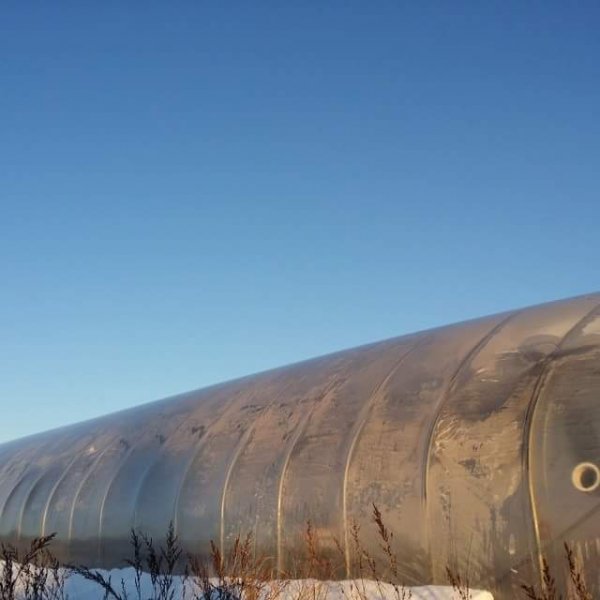

    Greenhouse insulation would be equivalent to about 1 to 1.5R value. It's double inflated 4 mil poly.

    When it's sunny out it gets 65 during the day. Without any heat. So I think I may dive more into extra water this summer. That with seasoned wood and better exchangers hopefully I will see improvements.
