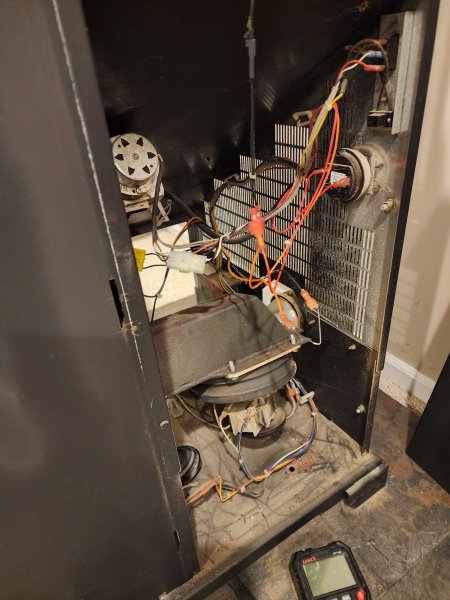

    I have a multi meter. I did try to jump both wires of the vac switch and lid switch. I'm still not getting the auger to move.
    When I tested the 2 auger wires I wasn't getting any 12v from them.
    Things to note. Lost power the other night for a couple hours, after the power came back the stove didn't work. I do have the stove hooked to a surge protector, but it's old so maybe it's not any good.
    I always don't hear the computer click when the hopper lid is shut or jumped. Last night all 3 computer lights where on. Red, green, blinking blue. Now the green is not light. I'm guessing I need a new computer?

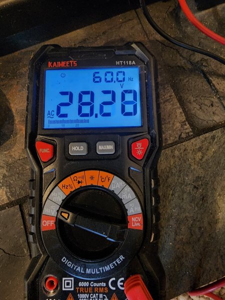

    You should be getting 120 volts (ish) to the vac switch....maybe 12v was a typo?
    But it sounds like the board probably took a dump

    Yes typo, 120v.
    Vacuum switch is only getting 28v

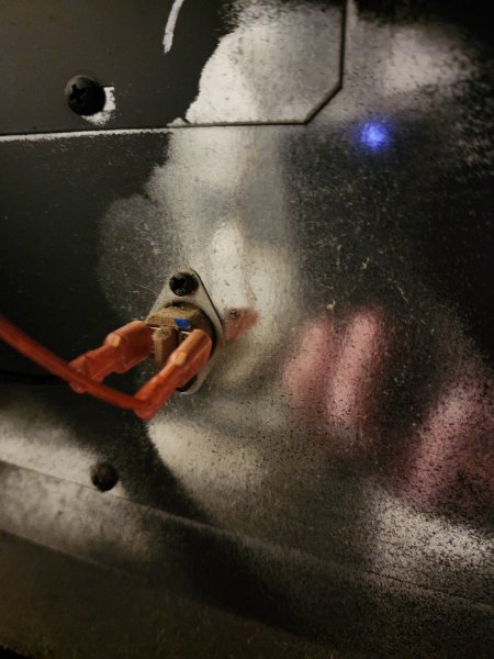

    I decided to check the snap disk by shorting out the ones that affect fuel delivery. After shorting out disk 2 the auger start humming and the little rod in the middle started spinning.
    We where all sleeping when the power went out, maybe the stove was running and it over heated with the fans off?
    The stove is running normal now with disk 2 shorted out. I will let it cool, restart one more time. If it's good I'll order a new disk.

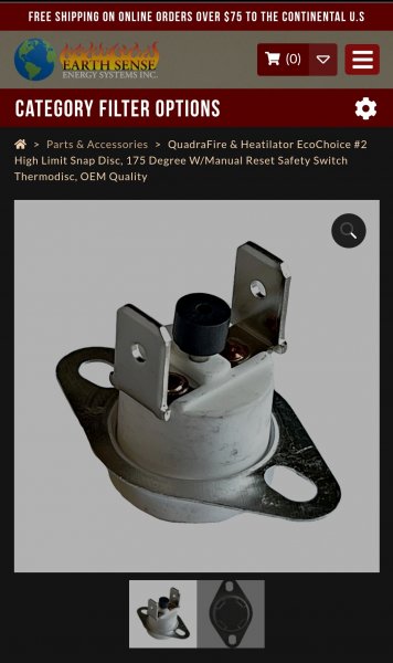

    I was looking up the part and what do I see. It's a manual reset. Sure enough it was tripped. Reset it and hooked everything back up. She's running again. Free fix, guess it's my lucky day. Looked up computer prices and yikes!

    So snap disk #2 on yours has a manual reset on it? I don't think I've seen that before. #3 yes but not #2....very interesting

    I didn't know either, but I'm gonna take this as a win.
