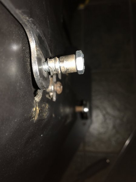

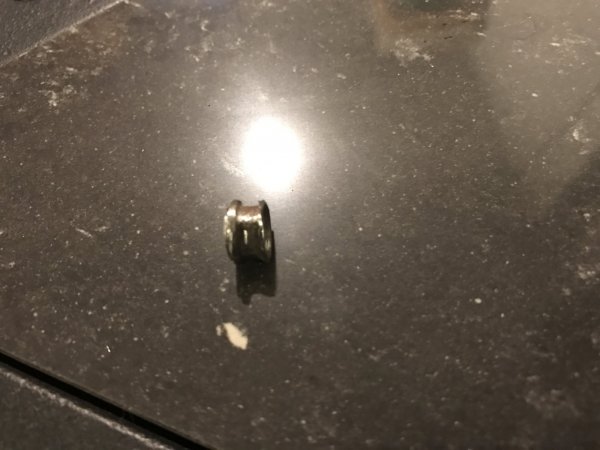

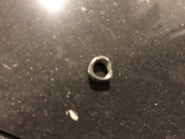

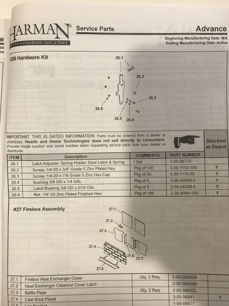

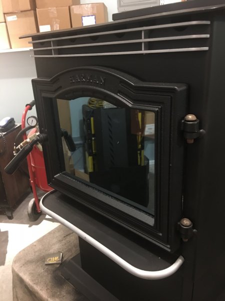

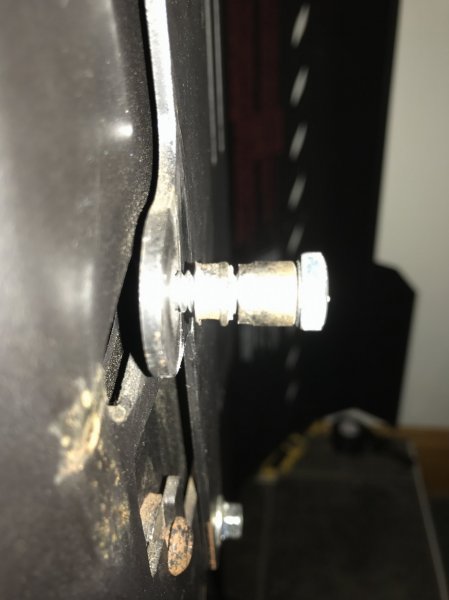

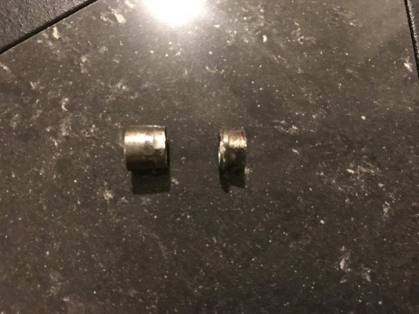

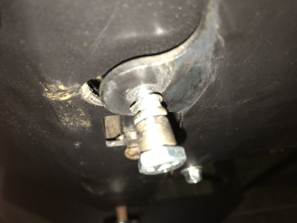

    I'm finally getting around to installing the 2014 advance that I picked up a few months ago. It's going right where the old one was so a pretty easy swap out. Got stove in and prepped it for the summer. Put the door on and not happy with how it latches. Failing the $1 bill test big time. Check out the bushing. Completely worn down to the point that when I engage the latch it barely even moves the spring. Went to dealer but he doesn't stock them. Had to order but they only come in packs of 5 I guess. There's 2 bushings and they are different diameter according to parts list so I had to order 5 pack of each to the tune if $33. Anyone ever experience this

    Parts list

    can you use a sleeve bearing? Might actually work.....its really just a roller

    I'll see if I can get my hands on something to make it work. Any suggestions on where to find a sleeve bearing
  5. jtakeman
    11,734
    52,707
    Any industrial supply house should be able to get them. Graingers is a good start.
    Let me know if ya get stuck or can't find one.

    Put the new bushings in. While there's improvement the door seal isn't where it needs to be. I have a tight seal everywhere except for the top of the door. Fluffing up the gasket helps but I think I'll replace it now before the season hits. I was gonna head to the dealer but thought I'd take a quick look on line 1st and found 2 different gaskets .I remember changing the gasket on my 2004 advance and it was the lighter colored one. This gasket that needs to be replaced looks like a graphite gasket. The lighter color one says it's a tadpole gasket and OEM. They both have the same part number. Which one ?

    I think they are very similar. The Advance must use a tadpole gasket because it goes under the bracket that helps hold the glass in. So the OEM gasket is the one to use. Can you replace mine too. :)

    It'll be interesting to see which one my dealer carries. Definitely the toughest door gasket to do of all the Harman stoves. Hey don. I'll do the stove for you if you want to drive the 90mins to drop it off
