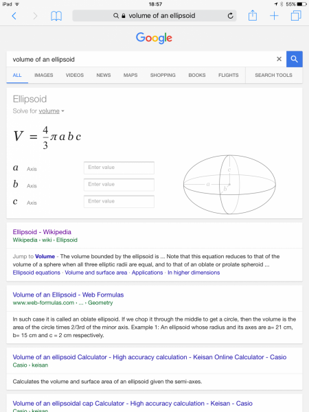

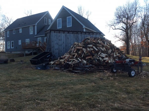

    IMG_0311.PNG IMG_0299.JPG I'll split and chuck into a pile, more longer than round.
    To estimate what I have as stacked I use the equation for an elipsoid,,,,the pile is kinda egg like.
    With that value I divide it by half, for half an egg.
    Then I multiply that by 70% to account for loose stack and not being quite an elipsoid.
    With that, I divide by 128 to get the number of cords.
    It gets me close enough so I can stop getting wood to fill the shed and turn my attention on getting stuff down in the woods for the following season after or hopefully further.
