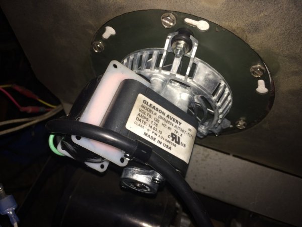

    I installed a new auger motor the old one quit (well stripped is more correct) after 30+ tons, that piece of corrugated card board was the last straw.
    Has a nice quiet new Gleason Avery in it. I also stopped some harmonic noises by using some gasket material. The stove is a lot quieter now.

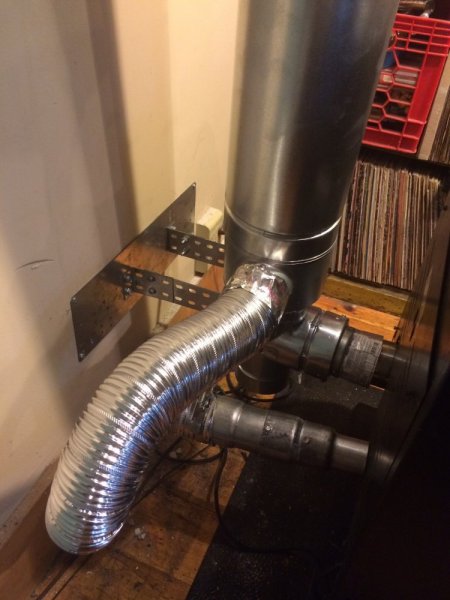

    The best oak is the one that warms and dries out the burn air. I just installed one on a Whitfield yesterday. The vacuum cleanout makes vent cleaning a breeze! It's like a Whitfield on steroids now!

    3 adapters on the oak?

    There is certainly a lot going on in that pic!!
    You couldn't find one adapter Don?

    I just used a hose clamp around the adapter on mine. It sealed it up pretty good. It's not the best looking rig I've ever done, but it's in the basement and on the back of the furnace and nobody looks at it but me.

    I used a 3" flex vent and put it over my 2" (maybe 2.5"?) On my Pellet furnace.
    I just cut some slots in the flex vent and then kinda overlapped a fee of them, and tightened the hose clamp. Looks good and it's functional.

    Same thing I did. I was lucky enough to have an exhaust adapter from years past in the bottom of the toolbox.
    I can pop it right off the air intake if needed on those rare winter days when we have a strong east wind.

    Yes, I am lucky I could find any adapter! The code is that they must be fire proof! Yet no stove or venting company makes an adapter from 3"to 2" and most stoves are 2" !!
    So I put a self tapping SS screw and clear RTV to secure them and make them air tight!
    The wall plate screwed into the wall studs is Very Strong! Nothing is going anywhere!
    Also very easy to remove them from the stove for service!

    Yes, cutting slits and clamping it Dexter that does work well! I have done that too.

    Looks more like a Turbo charger to me [​IMG]
