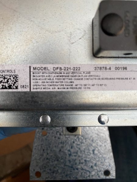

    My wife and I headed over yesterday afternoon. My wife’s coworker was there; along with her parents. Here father is a really handy guy. He had made up a vacuum bypass and a plug with spade connectors to test the combustion blower.
    Long story short, the combustion fan was not spinning freely. However, after vacuuming and turning the stove on while on the rails (cover that outlet on the on combustion blower!) and it started spinning a lot better. Bypassing the vac switch allowed the stove to start. We tried cleaning out the vac line, but no dice. So it appears a new vac switch is needed.
    I pulled the numbers off the switch after it was removed and no real surprise, it’s a common unit you can order from many supply houses and you don’t have to find one on a site that sells pellet parts.
    So more to come on this! Having the service rails were really handy. I was shocked to hear that the last company there did not pull the stove out; they took the surround off and tried accessing things that way. They were the ones who suggested just getting a new mother board, daughter board, combustion blower and temp sensor. Oh, and another vendor came out to clean the chimney…and didn’t pull the stove out when they did so. I gave the stove a very thourough cleaning when it was out on the rails…and the inside of the brick firebox too.
    For anyone curious, here’s the part number from the vacuums switch. I’m going to assume this is the same for the GCI60.
