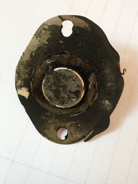

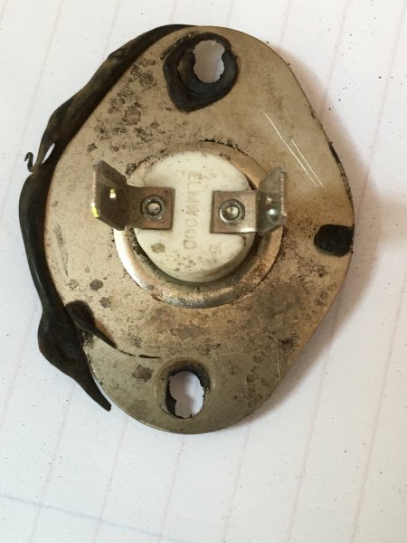

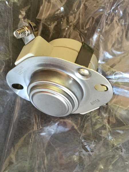

    Hello

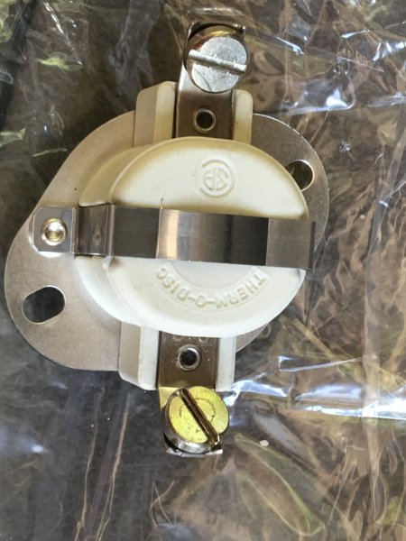

    Lately I have seen failures of those mini 120 Deg F OEM ceramic discs used as proof or fire (Flashing Heat Level 3) light also used to turn on the convection fan or room blower in the Enviro Maxx and Enviro M55.
    Now Breckwell stoves also use the mini 120 ceramic snaps and I have changed quite a few there too. The Breckwell exhaust housing can be changed to a housing with a larger hole quite easily.
    Now those good old Travis pellet stoves use reliable 120 Deg F full size 3/4 inch ceramic low limit snap discs that last a very long time. Even Napoleon and Whitfield use 3/4 inch 140 Deg F ceramic snap discs. With tolarances of +or- 20 Degs the spec of 140 is really not much different here.
    Interesting enough the Enviro Maxx has a hole large enough in the exhaust blower housing to accommodate the large disc. Is Enviro short changing us here?
    The M55 has a smaller hole in the exhaust housing but by using a step drill bit, this hole can be easily expanded to accommodate either the larger 3/4 inch snap disc or the small mini snap disc.
    In both stoves, the stove started with a nice fire and and then the auger stopped, the fire died out and heat level 3 started blinking.
    The current mini ceramic OEM replacement part is approx $63.00 OnLine part # P/N: EC-001 (Replaces Regency P/N: GF55-009)
    The large and better ceramic snap can be found quite a bit cheaper!
    Now keep in mind that these snap discs are ALL made by 1 or 2 snap disc manufacturers so nothing proprietary here folks really.
    So which would you choose for your stove?
    Pic 1-2 Mini Ceramic 120 Deg F OEM Snap Disc
    Pic 3-4 3/4 inch full size ceramic snap that comes in 120 Deg F or 140 Deg F. That is Beefy!

    I would toss the little failure prone unit in the trash bin and auger out the hole and install the 3/4 "more durable ones" in a heart beat
