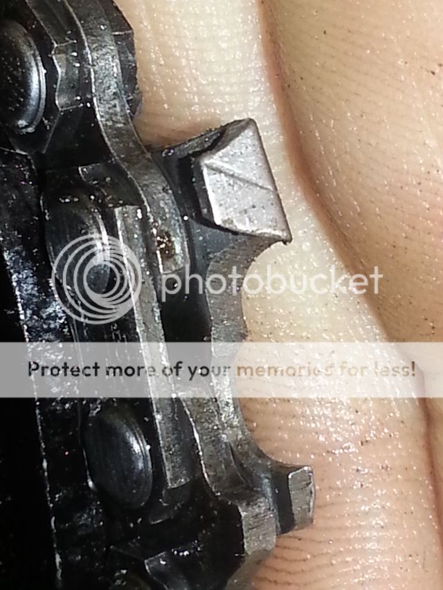

    The wheels on my Roughneck grinder are wearing down fast.
    Have you guys ever seen a cutter that was dull on both sides? The chain came with a saw I bought.

    Uhhh. They must of run that bad boy backwards for awhile!!! Or either ran it backwards to rock it?
    Maybe they tried to sharpen the backside?

    I got another chain from the same person and it had been ran backwards too. It was not rocked out on the backside like this one.

    How can you not realize something is wrong? They smoke like crazy throw dust and most important...they dont cut!!! You would have to run one a lot to dull it out like that!

    Maybe his sharpened chain did not cut any better than what it did backwards.
