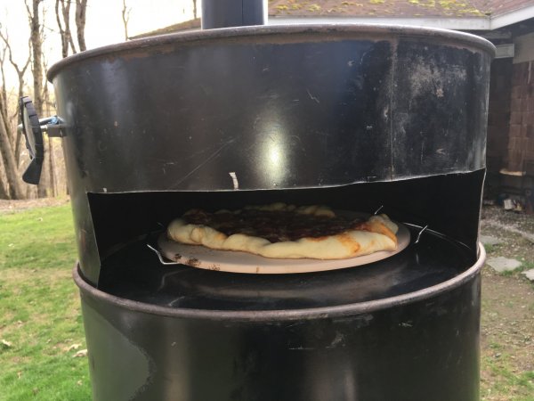

    Thanks guys! Turbo, here's one of my ceramic fiber patio heaters from a couple years ago now.....

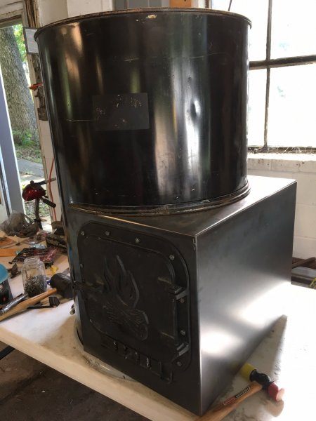

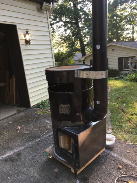

    If you haven’t tried compressed sawdust fire brick fuel in your batch box Stoves, do me a favor and give it a try? It’s extended burn times 3 or 4 fold in my prototypes and I’m thinking this is probably universal due to their density and lower surface area, but still providing the most intense burns.
    My current stove prototype, using a ceramic fiber board core and a batch box (which you may have already seen at the rocket heater forums): 29F4B6CC-620E-4CE8-AF20-3DC43C8937B0.jpeg 6CD07DED-FCB3-4A84-9C35-7C5D213C5AD3.jpeg 0E847961-9997-4B75-A6BB-74D1D3D73111.jpeg 3B522C1F-62F3-4505-B07B-ECBA2FAC5C52.jpeg
