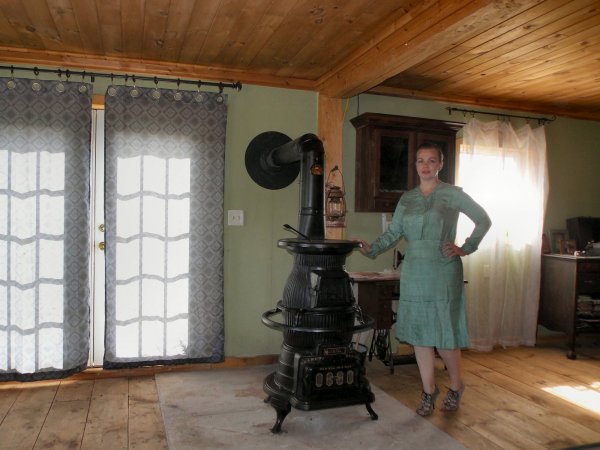

    I spent the money on a nice stove.upstairs because with an open floor plan on the first floor, it's a huge focal point, so I wanted something attractive. But not as attractive as that pot bellied stove LodgedTree has. Man, that really is a nice looking stove!
