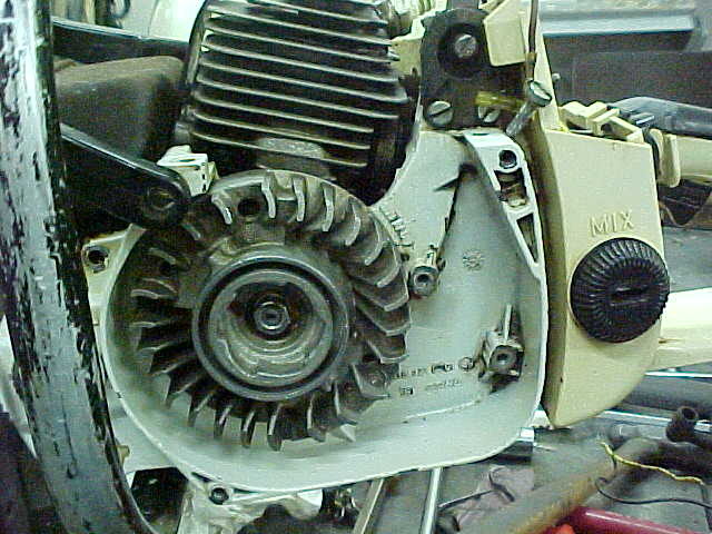

    Okay, Sorry for the delay on getting back on this but the new coil came and I finally had some time today to install it. Here we go.
    From what I have been told this is the same on the 028 6through 440 saws so this may be of some help to you guys. Video says you do not have to even take off the flywheel or remove points. I allready had the flywheel loose so it wasn't a big deal. Here is where I started after removing the starter cover.

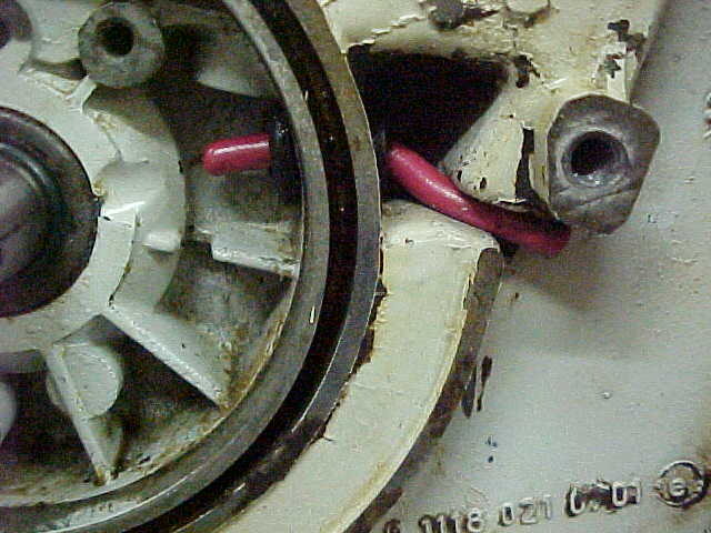

    Loosened the coil screws and took the points off. Time for a clean up!

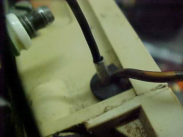

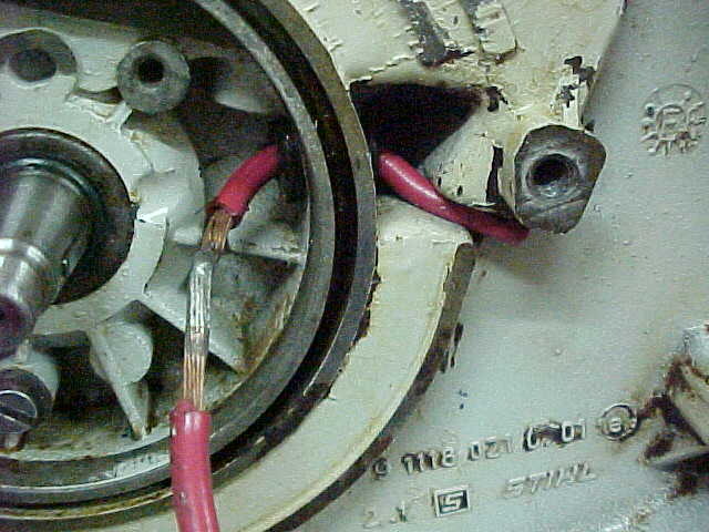

    Where the wires come through there is a rubber grommet. You could dab it with silicon but I feed a larger wire though to plug the hole. This size wire snaps in the case so it isn't going anywhere. I'll snip the end off so it can't come in contact with anything.
    Nice and tidy so that no dirt will get in there.
    Before putting the flywheel back on I sanded, by hand, the contact points on the magnets.

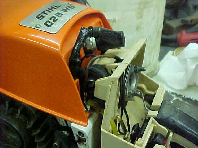

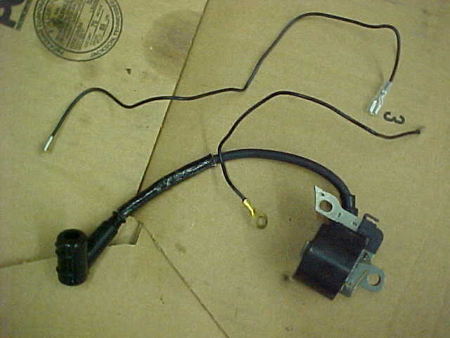

    Here is the new electronic coil. Came with all the wires cut to the correct length and plug end and boot on it. SWEET. Plug and play.
    I took the top cover off the saw to make it easier but the say you don't have to. I wanted to clean it up anyway. I then fed the new kill wire through to the switch.

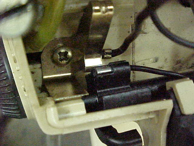

    Pushed the other end of the kill switch wire into place.
    Put the cover back on and reused my original second wire coming from the switch to the cover screw. This screw is the ground to case to complete the circuit.

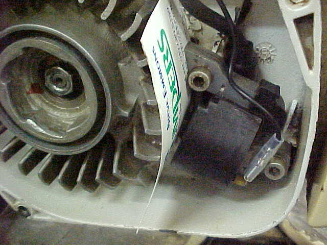

    Snugged the coil up pulling it away from the flywheel as much as possible. Put a .010 bus. card between the flywheel and coil, make sure to align the magnets on the flywheel to coil. Loosened the screws and retighten them.
    I then put the starter cover back on. Pulled twice and nothing. Third time it popped pretty good but so did the starter rewind. Pulled it off and plastic had broke and messed up the spring. MY LUCK.

    Hi Kevin, not sure if you mentioned, but where did you get the coil and is it OEM?
    I haven't had time to revisit my 038M, but I'm nearly certain I have a coil issue as well. I am fairly certain the 028/038 series share coils.
    Kevin in Ohio likes this.
  14. Kevin in Ohio
    Kevin in Ohio
    Oct 15, 2014
    1,006
    5,822
    It's a replacement coil, not OEM Stihl. I got it from Lil Red Barn

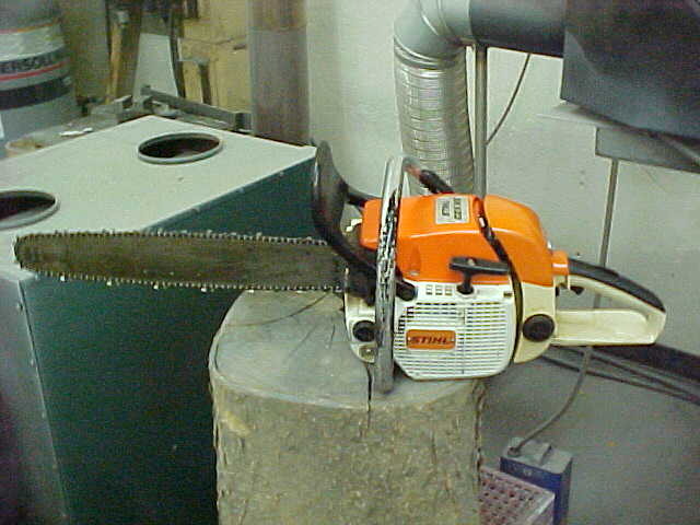

    If you notice in the first pic it had a faded yellow name tag on it. If I had to guess I'd say it was taken somewhere to be worked on. They may have redone the carb thinking as others that it would solve it. Once it didn't they may have given up as it "looked" like the spark was okay. We'll never know but it doesn't matter at this point. I runs great and that is what I was after.
    Did just go get an air filter for it OUCH! $32.00 as it has a choke assembly built into it. They set it was a rare version and they looked it up. Seems a Stihl 028 was only made from 1979 - 1980. I did price elsewhere before going and others want $28.00 and you get a plug and fuel filter. I wanted to play and with shipping it would have been close to a wash.
