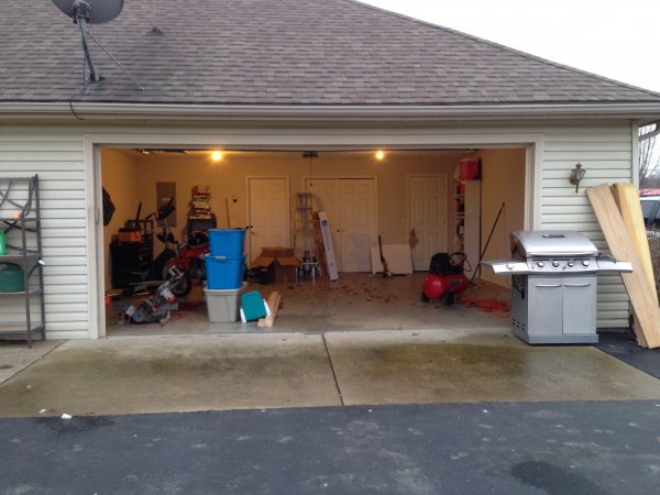

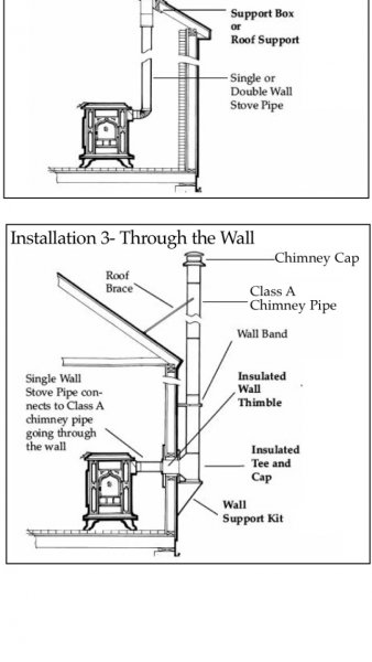

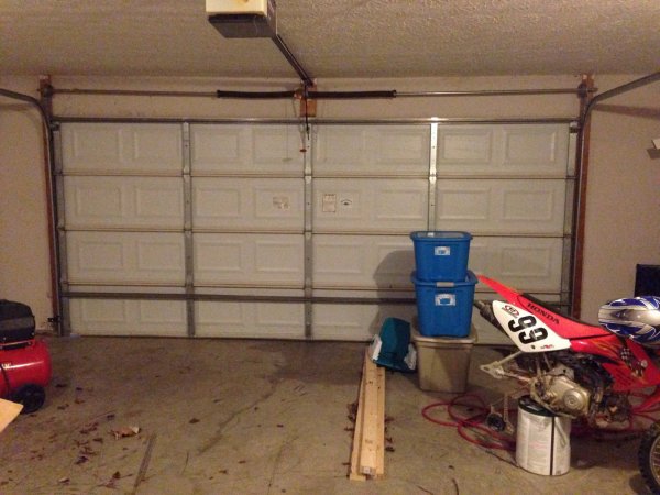

    Hi everyone! Fairly new to the forum... I am planning a permanent garage conversion (garage is located in the back of my house) in about 8 weeks, and have decided to incorporate a wood stove into the plans! After much research, and with the help of all your reviews/input, have decided on the Woodstock Ideal Steel. (I'll be calling before the free shipping promo ends! :) now that I've picked my stove, I need to decide whether to have it installed (I will be having it installed by a pro) top-vent or rear-vent. Since I have essentially a "clean slate" to work with here, would there be any advantage to one over the other? If you guys were in my shoes, how would you install?Per the ideal steel owner's manual, the completed height minimum is 15' for the stovepipe/chimney. So if I go top-vent, I'm thinking I'll have about 9' of class A flu through the roof. If I go rear-vent through the (yet to be built) wall, I would probably have the 15' flu "boxed in" with the matching vinyl, etc. sorry this was so long! I just wanted to hopefully make it clear as mud what it is I'm asking. Here are some pics of what we have to work with! I've also included a couple of images from the stove manual, showing my options. (Stove and hearth will be placed smack-dab where the middle of the garage door is, as close to the wall as possible) image.jpg image.jpg

    First welcome to FHC Brad38! As far as chimneys go sraight up will draft best. I look forward to seeing your new install.

    I would go straight up through the ceiling and out the roof. Similar to the Installation 1 diagram, but with the stove top vented. Better draft and cheaper- less Class A, less framing, less siding, possibly less chimney to meet the 2-3-10 rule (vs through the wall).

    As long as I have the choice always straight up, better draft + more interior stovepipe and that will keep your chimney hotter , less chance of creosote

    Don't get me wrong they work but, Out the wall, outside the house chimney, is the worst choice if you have the choice,
