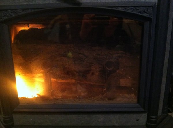

    Well, here it is. A full load in the PH. I'm going to shoot for a long, slow burn. The weather seems about right for it. It is 29 out right now and is suppose to hold there all night and actually warm a couple degrees by morning. The high tomorrow is right around 40.
    A couple potential issue with this test burn:
    1. I have to work tomorrow. So, I will monitor the load until bed and again in the morning. We'll see if we make it until I get home tomorrow. If not, I will instruct my wife to note the time she turns the stove up and/or reloads. I'll also ask her to take a picture of the coals and note the stove temp if she reloads, but she is certain to roll her eyes. :rolleyes:
    2. I sometimes get the stubborn yet faint smoke smell if I run a load turned down too far. If that happens, I will need to open the draft a little bit (and subsequently maybe a window). However, all indications are that that issue with the PH has been fixed. I just haven't upgraded yet.
    3. I haven't cleaned the flyash off the window in quite a while so pictures from the front aren't going to be that great.

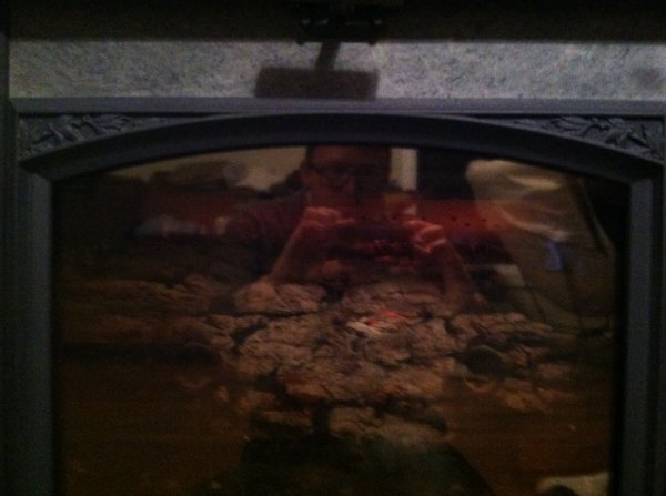

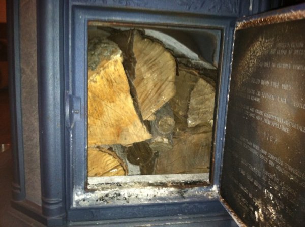

    Here is the load:
    7*7.5*21.5 Sugar Maple
    6*6*19 Sugar Maple
    5*5*21 Sugar Maple
    4*7*18 Ironwood
    2 small beech rounds (for filler)
    4*5*19 Sugar Maple
    It's pretty darn full.

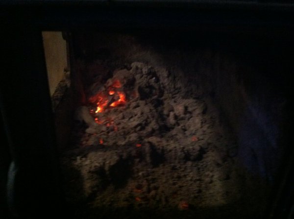

    Here are the coals that I loaded on after an 11 hour burn on just over a half load:
    There were actually way more than that but I shovel some ash out of the stove for the test burn. I shoveled with the stove way hotter than I normally would, so I lost quite a few coals.

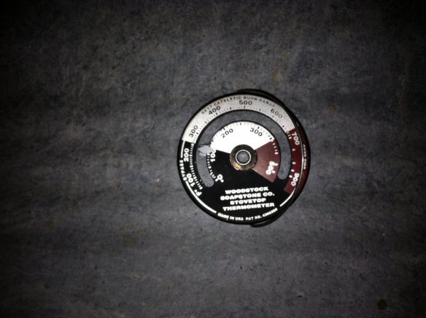

    Stovetop was at 240 when I loaded. House was at 68 degrees:
    I loaded at 6:18pm. Stay tuned.

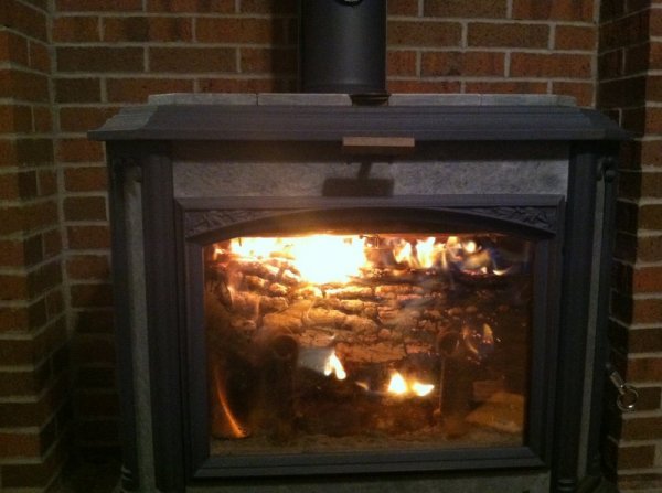

    This load took a little longer to get going than normal. But, large sugar maple splits aren't know for their instant flame!
    After 5 minutes:
    After 15 minutes, I notched the draft down about 1/3. Exterior single wall flue temp at 250:
    Then, at the 18 minute mark, I notched the draft down to half open.
    After 21 minutes, I engaged the cat with the draft still half open. Exterior flue temp was 340. Just before engaging the cat, it looked like this:
    Just after engaging the cat, it looked liked this:

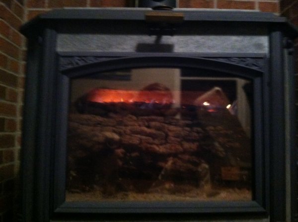

    I gave it another 5 minutes with the draft half open. The flame died out to just a little off the top of the splits and some light secondaries:
    I'm going to give it a few here as it's not going that great and I don't want to stall the cat.

    All right, I'm settled in here. A little less 40 minutes after loading (this is way longer than normal), I'm set with the draft just a hair above closed. Stovetop at 350 and climbing. Just a touch of secondaries going. Pic coming....

    This^ This is a great photo. It is showing very little flame. I am very interested in knowing how this burns. Will it maintain the low burn or will it flame up and eat into the wood?
    Thank you for doing this.

    Well, I could have definitely fit more in, but I wanted it to be a realistic full load and not a search through the stacks and assemble a jigsaw puzzle full load. ;)
