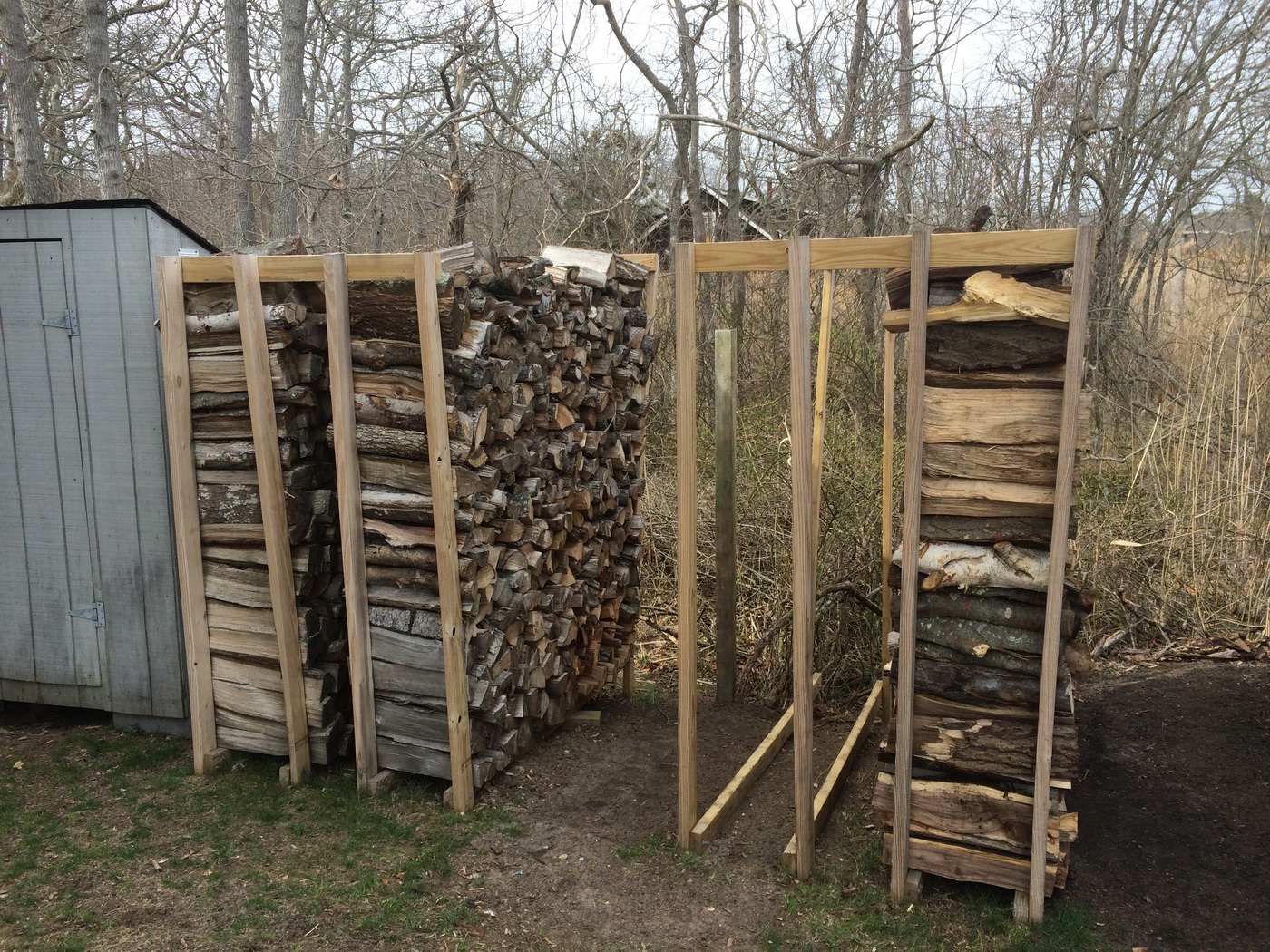

My "north" racks. Each averages 7.5-8' tall x 7.5' long, by 18 to 20" splits. Each holds about 0.75 cord for a total of about 3 cord. I built this with 10' long treated 2x4's, sunk into the ground and then bolted together on the bottom with galvanized bolts.

    Nice-will you cover them?

    Yes, they are covered with a custom fitted canvas cover. I'll post a pic....
