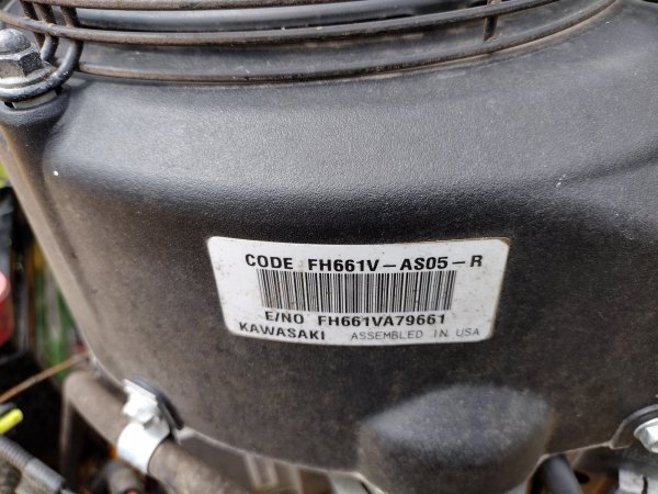

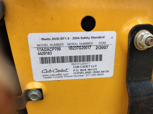

    Low oil light is on. Oil is full and oil pressure sensor has been replaced.
    Still not starting. Will crank but no spark. IMG_20230612_114338665_HDR.jpg IMG_20230612_114318214_HDR.jpg

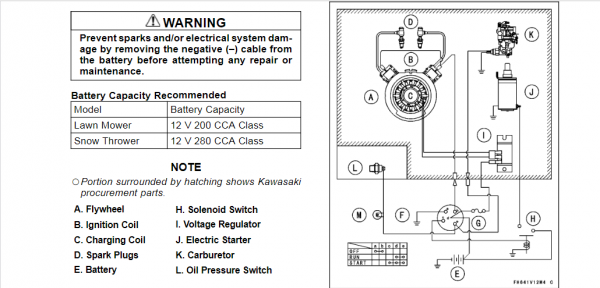

    I looked up the wiring diagram for this engine, it shows that the sensor is a pressure switch, it just turns the warning light on/off, that's it, no ties to the ignition.
    I'd do a couple things, get a test light, or multimeter and check the power (terminal e on the key switch) and ground to the fuel solenoid at the carburetor. You could also unplug the coil wire that goes to terminal b on the key switch, (I'd try to unplug it at the coil, or wherever convenient) that would make sure that the ignition coils are not grounded out ("turned off") this would actually be my first test, since the oil light is on, which means the terminal that feeds the oil light and fuel solenoid is powered up...so unless there is a bad connection, or a broken wire (power or ground) the fuel solenoid should be working...and, your issue currently is no spark. Chances are really low that you lost 2 coils at the exact same time, and they are pretty much self contained, so my money is on that they work when the "off"/ground wire is unplugged...which will have to be put back on to kill it if the engine starts...that, or run it out of fuel! :rofl: :lol:

    It's fixed.
    Had a wire under the seat pan and above the mower deck shorted to ground. had to disassemble 1/2 the mower to find it.
