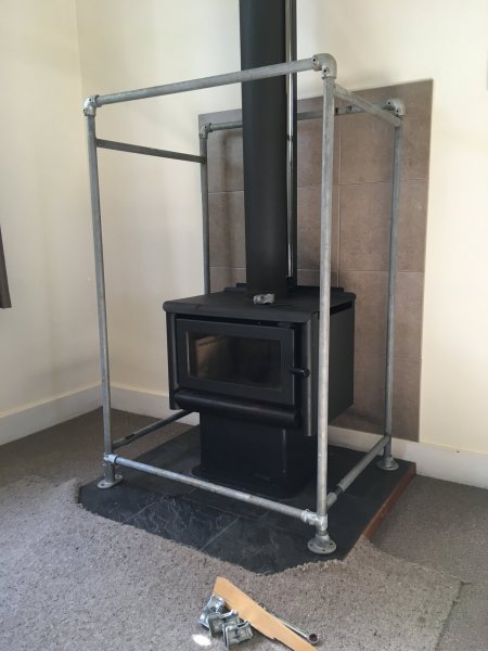

    Finally got a provisional frame up last night for my "kiln rack". For those of you new to the thread, this structure is intended to safely stack imperfectly seasoned softwood around/above the wood burner to "finish" it before chopping it for kindling.
    I'm just going to look at it like this for a couple of days before I start putting shelf racks and then wood on it, because I get really annoyed with myself if I see a better way of doing things when it's too late.
    Plus of course a City Council building inspector and engineer will have to inspect it. With the architect's plans and application fees it shouldn't cost more than about $2,000 to get planning approval and a code compliance certificate, so it'll be totally worth it to save buying a couple of sacks of seasoned kindling.
    It's kind of weird to look at it - I mean more weird than just the fact of having pipework in your living room. It's almost as if a team of pixies is going to refurbish the wood burner and they're setting up their scaffolding.

    I made some progress on the kiln rack today. Can you spot the differences? Answers below.
    1. Most important, I put a diagonal cross brace at the back to improve the rigidity.
    2. Second most important, I made some under-feet pads. The base is textured flagstones, and flat steel against uneven stone is a recipe for disaster once the load goes on, so there's some cardboard first, cut to compensate for the dips, then some thin plywood (3-ply) then some squares of tough flooring vinyl.
    3. Used two "thru" cross bars at the top with tees instead of elbows. The tees really "square up" the angles and are much stronger than the elbows, which just use a set screw to tighten rather than a bolt to clamp both pipes across most of their circumference.
    4. Each side piece had a matching pair of feet: circular on one and oval on the other. Swapped them so that the fronts were circular and the backs were oval, with the flange facing outward for additional lateral stability.
    5. Added two extra cross bars for the first shelf (not made yet), which also stiffened the structure.
    6. Added a metal mesh 'shelf' with a cutout for the flue and small pipes under it for support.
    You probably have some questions, so here's a quick Q&A
    • Is this the greatest feat of engineering since the pyramids?
      The pyramids were basically just one block of stone on top of another, so I don't think there's really much comparison. And, no, I don't consider myself a "genius".
    • Who said anything about "genius".
      It was implied.
    • Can I have one of these for myself?
      I'm hoping to make the plans available, but first let me ask you: Would you expect to pay $500 for them? Would you expect to pay $300? Well I say that price is Too High. For three easy payments of only $99.99 this Industrial Chic statement of good taste and engineering skill can be all yours**.
    (**Terms and conditions apply. Void where prohibited. May contain nuts. Objects in mirror are closer than they appear. You must be at least this tall to build this rack. May cause injury, dizziness, shortness of breath, and halitosis. Not to be used as a rack for drying or storing firewood.)
    I'm very happy with it. It's extremely solid now and strong.
    One thing I wonder is this: having cut many of these pipes, then having filed and chamfered the edges, there's a fair bit of steel showing that's no longer galvanized. So do any of you metal workers out there dress these surfaces with anything to minimize rust? Preferably some ordinary household product since this is a quick'n'dirty structure and I don't want to spend too much extra.
