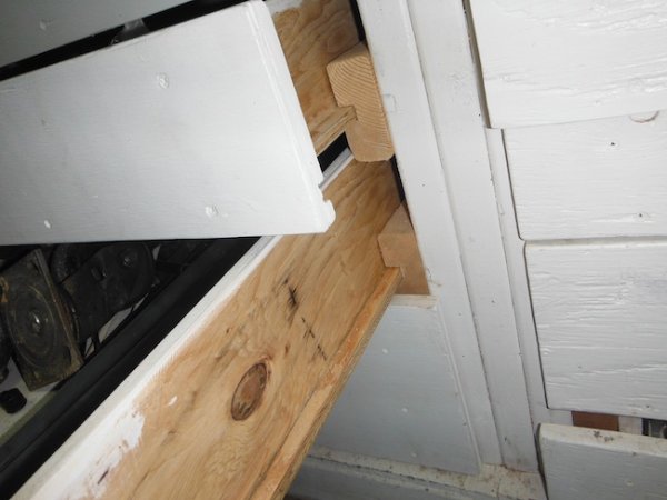

    Dado a grove (a hair bigger than 3/4" wide & 3/4 deep) in a 2x4 , use 3/4 plywood for shelf bottom. Paste wax the grove.
    Had some bearing drawer slides, used them on a few.

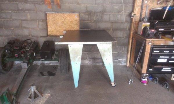

    My next big project is to dismantle the welding table and hinge the top to the side of the new workbench so it can hang when not in use or lift up to be used. Then I can keep all that angle iron for other projects…
