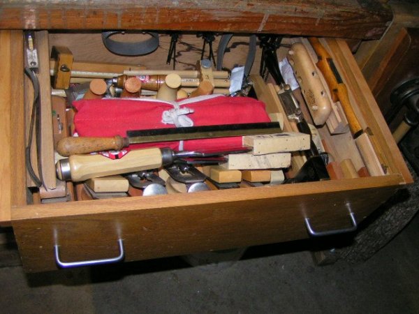

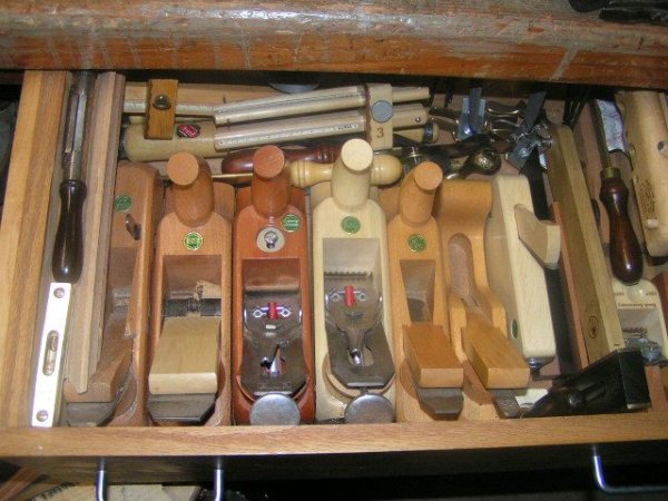

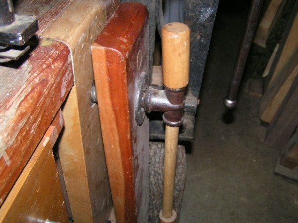

    Built this from 3 x 12 (top) & 3 x 6 (legs) old growth doug fir in Jan 1987.Left vise has extra large Cherry jaw milled from chunk of dead tree off parent's property.Right vise (hardware is salvaged 1oo+yr old iron screw,collar from old tapered leg vise) found at an estate sale in mid 80's.New Cherry jaw,Hard Maple back anchored to bench leg.
    Was fun boring a 1.125" hole 9" deep for that vise screw,tapered at far end,getting everything lined up & chiseling out a small notch so the iron locking collar wouldn't twist in the mounting hole....:hair:
    Small drawer on left made from Cherry scraps/salvaged old Oak drawer pull added later,same with the large one made from stained Red Oak plywood from a downtown hospital remodel.Not real fancy but bench is mega stout (300 lbs empty),very stable & top is smooth/ flat. Bolted to 80+ yr old concrete floor with 1/2" wedge anchors using 1/4" x 2 x 2 structural angle as the floor to bench mounting clips.
    Works for me.Someday I'll have a another large bench,such as the Sjobergs Elite w/cabinet or a similar European bench.One style of Ulmia bench I really liked but its not made anymore unfortunately.The Elite is a close substitute.

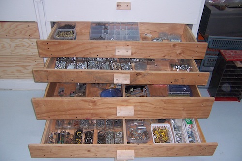

    I put drawers under the work bench. stuff more findable than on shelves.

    I don't remember ever seeing those.
    Really nice Dave.
