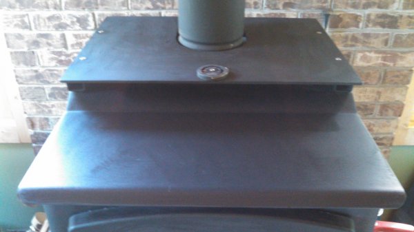

  17. papadave
    Pic from this morning on the stove.
    I wiped some dust off. :)
  18. NortheastAl
    NortheastAl
    4,887
    28,161
    Putnam County NY
    That's a really pro job, Dave. You might want to consider making and selling them.
