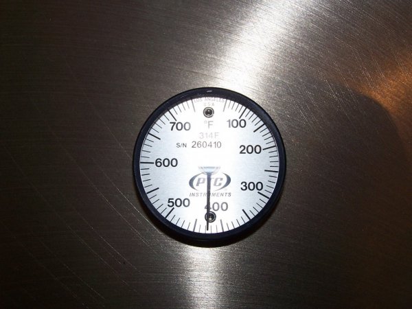

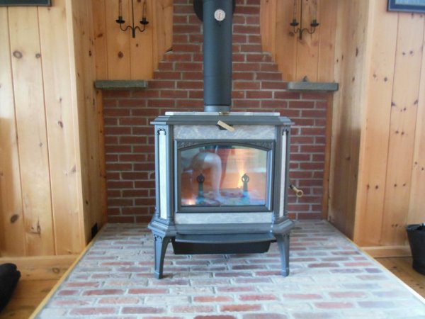

    PTC surface gauge and Tempoint Bacharach flue probe.. Both of my stoves use these gauges.

    do you leave the temp probe in the flue all the time?

    Yes, the probes stay in both stoves all the time... Easy to see the needle from across the room.. Plus the probe can be calibrated in boiling water..

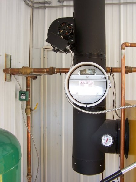

    Yes you can use it on a single wall as well... Here's where I first use one of these probes , on my single wall pipe on my Paxo 60 gasification boiler.. They are dead nuts accurate and you can also check them by simply putting the probe in boiling water, should read 212 degrees. If nit you can adjust the probe to read correctly.. BrianK just brought one on here and said he tested as new in boiling water and it was right on.. What ever works for you...

    If I was to replace my probe, this probe is what I would have. As for surface, the Tel - Tru or PTC would be my top picks.
