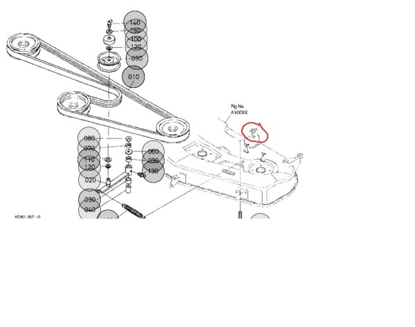

    Curios if the actual pitch measurement is wrong or their 'cross reference' is. BX2380 has an appetite for deck belts. When the last OEM let go I decided to measure it out and try an 'economical' version available to me via my workplace. Outside pitch ended up about 1/2 longer than OEM. Tensioner takes care of that little bit. My cost on non OEM is 22 bucks. My cost for OEM is $128 (online Coleman Equipment my go to for parts). The non OEM appears to be decently constructed (i know a thing or two because i've looked at a few thousand or two prior). If the replacement lasts the summer I won't be purchasing OEM for it anymore.
    All that said, my other mower still has the same belt (different beast all together) as when I bought it, and it was not new at that time. I blame the less than idea deck design on the 2380. The belt runs all the way across the back of the deck in a straight line with nothing to guide. It's always vibrating/slapping around, OEM or aftermarket belt. No such nonsense on the commercial deck. Belt makes contact on both sides at these little towers that attach to the leveling arms. Poor design, but I do have strong opinions on stamped vs welded decks.
