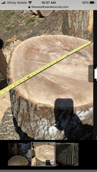

    Says my biggest piece is around 799lbs! No wonder I broke out in a small sweat moving it. May check the other ones later on. Thanks for the calculator, saved it in my favorites.

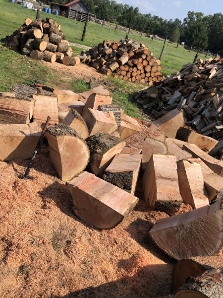

    Busted my butt getting these into half moon pieces small enough the log lift can handle. Ran two tanks of gas through the saw cutting 17 pieces and noodling them far enough down that I could bust in half with a maul. I took off my dri fit shirt and wrung it out twice...don’t think that’s supposed to happen lol. Now eating a popsicle before cutting some normal size wood! Oh, and my shorts looks like I peed myself. Haha

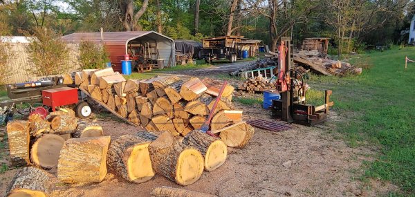

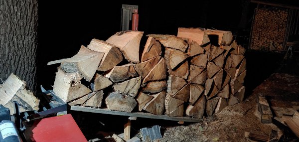

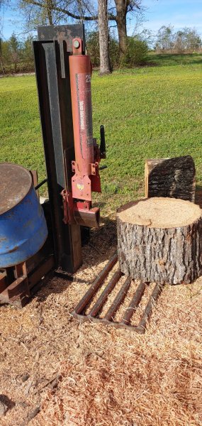

    Guess we are blessed to have the equipment to do it. As TurboDiesel said, we use the 25 ton splitter to break them down, metal grate makes sliding them much easier. 0326201012.jpg Then put the pieces on the ramps to the fast cycle splitter to finish. 0328201902.jpg Thanks to the calculator, this 38"×32×6' log weighs about 2560#. 0717201213b.jpg
    I broke down 6 rounds that size last night 0721202127_HDR.jpg Some of the biggest we have ever had...

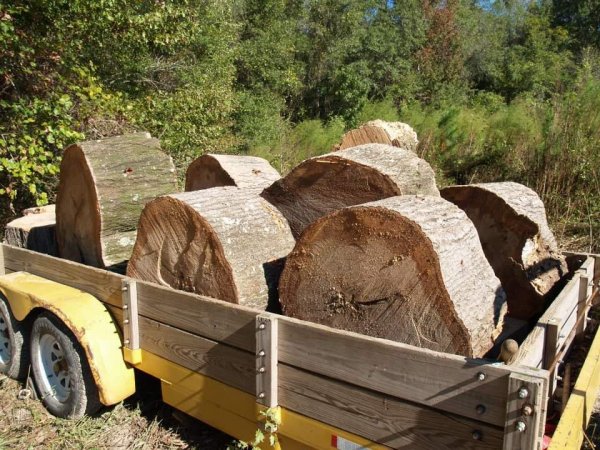

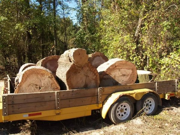

    These last 3 pics are 1 load/ 1 spar take down, tractor would only handle 20" long round. 8 rounds on the trailer, almost 8k. Avg weight was 975 # each. Glad that was yrs ago when Ibwas a young man...lol. FB_IMG_1549203245638.jpg FB_IMG_1549200590540.jpg FB_IMG_1549200659192.jpg

    How long are your rounds? No way those should exceed 500 pounds unless you are cutting 20-24" lengths.
    T.Jeff Veal and Screwloose like this.
  14. jrider
    jrider
    Feb 12, 2018
    6,088
    42,874
    16”
    Chaz and T.Jeff Veal like this.
  15. jrider
    jrider
    Feb 12, 2018
    6,088
    42,874
    Go to my thread “guess the weight game” from back in April. This 16” long 27” diameter red oak weighed 389 pounds

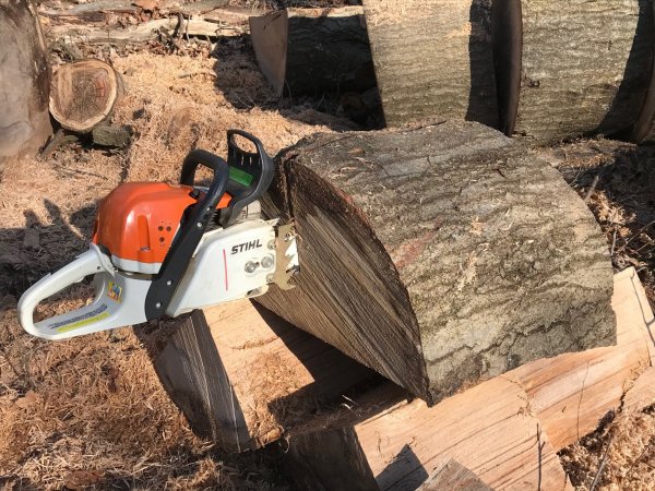

    Noodling lengthwise instead of "down" the log makes a HUGE difference in the time and effort it takes to noodle. Give it a try, it will work fine with the MS250. Slow and steady will still get it done.
    I don't noodle unless I have to, but I get into some big stuff occasionally. Normally I noodle with my 25" bar on either the 391 or the 362, but I have noodled 32" Pin Oak rounds with my MS250 just to see how it goes. I have an 18" bar on it and I cut rounds at 22" so I have to hit 'em from both ends. I always keep my chains sharp and although it is slower going, I was able to noodle some of that Pin Oak just fine with the 250. It clogs up with noodles quicker than the larger saws, but that's kinda to be expected with the smaller butt on the 250. Bigger saws are nice, but I'm a big believer in "run what you brung". MS250 is both an inexpensive and impressive saw with an excellent power to price ratio. They respond very well to a muffler mod also. I don't care what powerhead you have, the sharp chain is the winning ticket. $20 on a box of files is way cheaper than big saw that is only needed once in a blue moon. Speaking of blue moon, I'm thirsty... I better go grab a PBR... LOL
    I usually only noodle 2/3 of the way through then pop them the reset of the way with a wedge to save time.
    Nuthin' against big saws... I love em, just can't justify buying one for my needs.
    Proper orientation of the saw to noodle. I never timed one to see for sure but I would guess 3 to 5 times faster than cutting across like on an Alaska mill. This is the 391.
    This is the 250 and it noodled a few of these rounds cuz I ran out of gas in the 391, This saw orientation is the "hard way". It's just sitting in there for the picture.

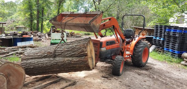

    I understand. I have lifted bigger and broke mine; but mine is not a TW either. When I had it fixed, the welding shop said it would mostly likely break again until I beefed up the construction. I will have a complete new lift built next time it breaks. I lift some heavy rounds with it (36" range of oak)---heavier than I thought according to your info. And it gets abused as a table; my helpers dropping rounds on it can't help.
  20. jrider
    jrider
    Feb 12, 2018
    6,088
    42,874
    Yeah when those big boys finally break apart they can be a real b*tch to try and catch. That’s why even though I don’t like to, I will noodle them in half once just so as not to bust up my equipment or worse yet my helpers
