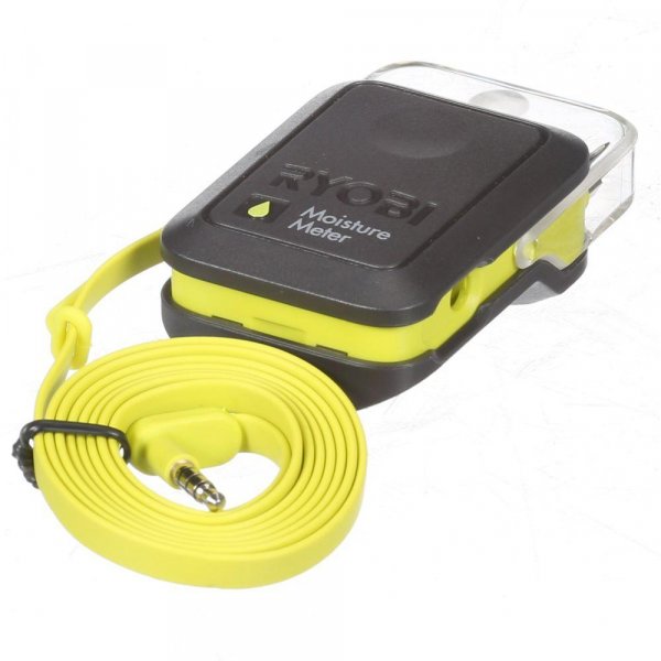

    stumplifter , if you have a smartphone, or tablet, buy this.... ryobi-specialty-hand-tools-es3000-64_1000.jpg
    Ryobi Phone Works Moisture Meter-ES3000 - The Home Depot
    next time you get to Rhinelander or Wausau, or any Home Depot will have it.
    These work very well, if you know how to follow instructions that is. There's no other moisture meter on the market that can do what this one can. I've had mine a couple of years, and I love it.

    Thanks for that link on the Ryobi moisture meter. I'll be looking into that bad boy since the I phone gets used for about everything else as well. I do have the cheap HF one that seems to work pretty well and have had it for years now but I doubt that it is anything like that smart phone Ryobi attachment meter. And the price seems quite reasonable. I need to get up to speed with the times and tech.
