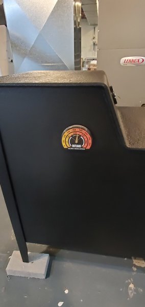

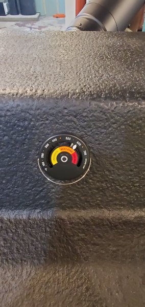

    What temp would you say is appropriate to run this unit at? I'm used to watching the stove pipe, but since I'm using this double all its a whole different ball game.

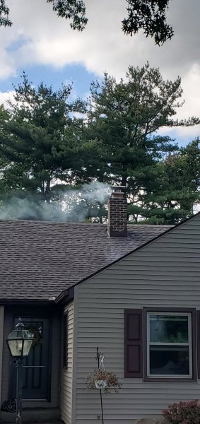

    Burning my "smoke the house out with paint fumes test fire" and boy I'll tell ya what - this unit is going to be a serious heater!!!

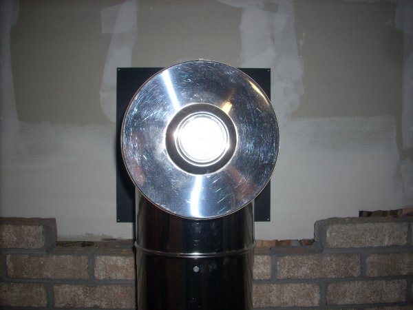

    This double wall is really nice I can just about lay my hand on it where it attaches to the masonry chimney/stainless liner. I have about 8' of pipe before it enters the thimble.
  2. brenndatomu
    25,246
    164,294
    Neighbors be like WTH! :startled: :rofl: :lol: :thumbs:
    Is that a probe type thermo, or just a mag type on the pipe? Probe type is what you want for doublewall...

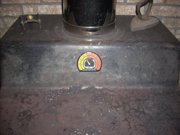

    I pipe temp and a side temp, don't worry so much about the stove, keep the flue/pipe about 400º. That's prime burning for that stove! :cool:

    Fortunately, where I live, I don't have any neighbors close enough to bother. Therfore, excessive smoke emissions is not a concern for me. With that said, once I reach an efficient burn, I should see all that smoke.

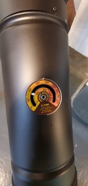

    Received my USA made Condor probe chimney thermometer yesterday and installed. According to the thermometers ranges, 400 degrees is at the bottom of the "ideal" range with 900 being the max. I'll shoot for around 400 based on Dave's recommendations.
    Currently, I am not burning as it is unusually warm here in NE but I'm anxious to finally have an accurate way to control the stove!
    I have a full wood ring if 3 year CCS black locust, cherry, sugar maple, and ash already in the basement. Wife thinks I'm insane, but I've had 2 box fans on low blowing on it for days now just to make sure it's ultra dry from any precipitation that has moistened it.

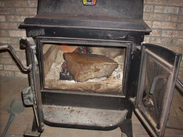

    How much wood are you putting int it??? You shouldn't have that issue at all! If you have more than 2 good size splits in there, "She'll get hot"! Here's what's in my stove right this minute during the day. The actual surface temp is about 300º.
    The only thing I'm thinking is you have way too much air and too much wood!
    o_O

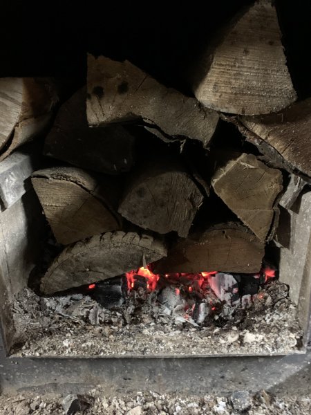

    E9EB2F19-FA5D-441B-84D5-436EBE5F3A74.jpeg My stove (not a fisher but basically the same idea) with a factory baffle is loaded like this load after load all winter and even with a strong wind won’t over fire if the knob on the front and the pipe damper are set properly. Some times the Mrs don’t shut her down enough and it gets hot!! I guess what I’m trying to say is the stove should be more controllable.
    WeldrDave and brenndatomu like this.
