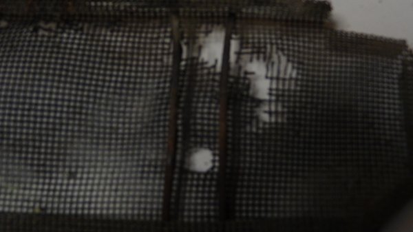

  15. Flamestead
    Flamestead
    Dec 7, 2013
    2,167
    10,974
    Windsor County, VT
    Just back from a weekend in Maine, and have a cold stove, so we hunted down some distilled water on the way home and cleaned the cat. Got the distilled water at the grocery store. I looked long and hard and was ready to give up. My wife walked over and pulled it right off the shelf.
    Ash-colored water during the rinse. I rinsed enough to get rid of all vinegar smell, but was still getting some ash-colored water. Now it is sitting on the hot air furnace vent, drying out a little. Still using the iconel screen, but it is not going to last forever...
