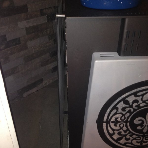

    Just order the IS rear heat shield and modify it. Here's mine. How difficult would it be?

    It will need some work. More space between the shield and the stove will be needed. Also, the top of the shield needs to extend above the stove top and curve over the stove top to promote air flow going across the top of the stove.
    But, with some spacers and some welding, that might be a good starting point.
