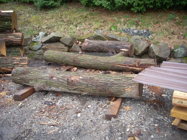

    I actually have a pile of elm to mill for a customer , smaller logs 10-14 inch he wants them milled live edge for shelving I will get a couple of pictures I hope to mill them this weekend he has used elm before for projects I will ask him about it for you JB

  9. JB Sawman
    JB Sawman
    Mar 10, 2018
    1,198
    7,318
    pennsylvania
    It is raining here today I will try to get a picture of the log pile today Kinda a before and after JB

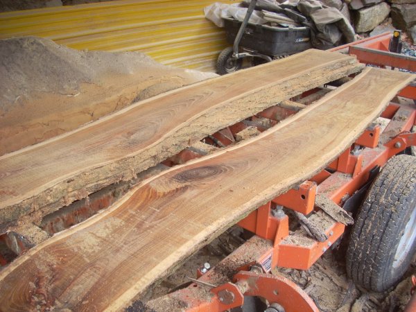

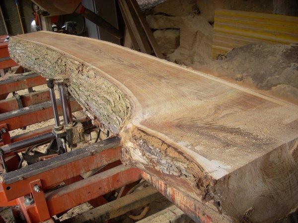

    Ok here they are before and after I was kind of in a hurry to get done so not a lot of pictures hope this helps your decision JB DSCN0366.JPG DSCN0367.JPG DSCN0365.JPG
