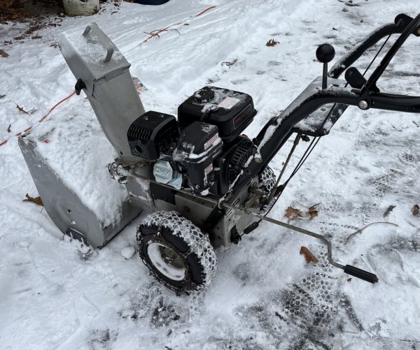

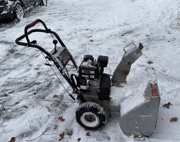

    This was an improvement over the tractor that didn’t want to run below 30 degrees last year. I picked up this junk Craftsman 5/23 (5HP x 23” wide) for $25 last month. The motor had almost no compression so I picked up a 6.5HP Predator from Harbor Freight. The original Tecumseh had 2 output shafts spinning opposite directions, whereas this has one shaft. I had to make a drive pulley and a tensioner, but I got it all to work. It starts right up (20 degrees out this morning) and threw the 8” of snow we got last night just fine. The OHV cover on this motor stuck out further than the original, so I had to remount the adjuster rod for the chute lower, then file/grind the notches so that the corkscrew engaged properly, rotating the chute.

    Nice work Eric! Sounds like a solid runner!

    I was sold on these engines this past summer when I put this exact one on my kid’s mini bike. For $150 they’re hard to argue with. Unbox them, mount them up, fill with oil and fuel and they just run. Zero complaints.
