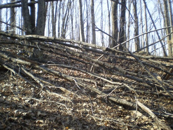

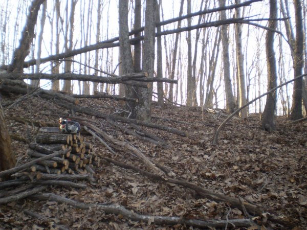

    I took the little echo up the hill and started working on the big oak blow down. I had to be careful because I was working on a slope covered in leaves and leaves on wood is slippery. I spent some time policing the area first. I did not get as much done as I would like but I did work slow. I only started this afternoon; I was suppose to be working on a site but the server went down on me; this is one of those shared hosting accounts. Therefore, I decided to grab the saw and go and work on the blown down. One section is hung up in a tree so that will be interesting; might have to leave part of it.

    Don't cut on the topside too much of that hang up...you want finish the cut underneath...
    Be careful.

    As mentioned above be careful. That looks like a steep little hill. Kinda looks like you might have some stuff thats got tension on it.

    While you can not tell, the part of the downed tree in the fork of the tree is way over my head. I am going to have to go up the hill and I guess cut, and under cut and let it drop until I can't any more. Which means leaving what can't be done. If there is advice on handling this, please share.

    As for the height of the snag, let's say for grins and giggles 12' up from the ground, estimate that back from the snag (and if it's at a safe height then) perform the safe cut and when the snag drops, the section of oak that's still left in the tree will drop to almost vertical. You may be able to man woman handle that freed up section out of the snagging oak to the ground.... and then proceed to recovering your farwood.
    Just like eatin' lettuce and kissing yer sister...... there's nothing to it.

    Yep. I work until I start feeling a few aches, and that's it for the day. Nice looking deadfalls.
