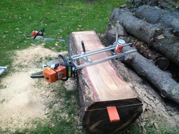

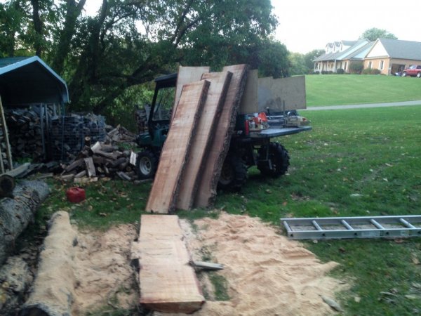

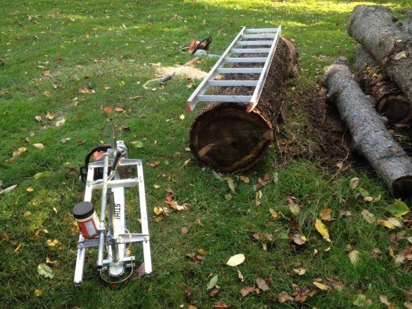

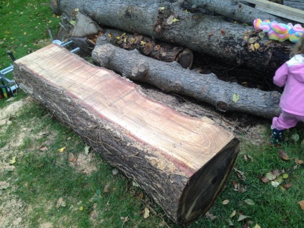

    Went out and milled a hemlock tonight. Made 4 slabs at 3". This was a log that had been bore cut into a few times so the first two slabs have a few cutsthrough them but the other two turned out nice.

    They turned out good! Won't be long you'll be making that table! Nice work!

    I can't imagine someone would bore cut through a log?!?! :whistle:
    I ain't saying any names:zip:
    Looks good Swags! Awesome job!
    How did that 460 preform? Do you need a 660?? :dancer::saw:

    The 460 did really good, I won't mention any names either on the bore cut. :whistle:
    They turned out good, might have to make a bench or something out of them when they dry.

    Looks dang nice Sean, is that he Alaskan mill?
    mdavlee likes this.
  16. swags
    swags Moderator
    4,455
    13,240
    Yes it is

    Under 20" wide you won't see much difference in the 460 and 660. Over that and you'll start to notice needing more torque.

    Those test cuts look like they came out good! Now i regret passing on that mill on CL a few months ago :(
