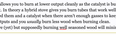

    WTF, is there another way to spell the word 'well' ?
