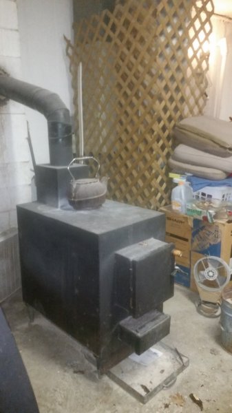

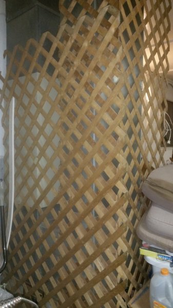

    Sorry for the mess. But this is our homemade garage stove and behind the Latisse is the furnace. I thought about going into the return (right side) because I would not have to worry about anything but empty duct.

    I have seen people with a similar looking stove make a shroud around the sides and top of the stove. Leave several inches for an air gap, add ductwork and come in the bottom of the shroud with your return and come out the top into the ductwork going to your vents in the house. Connect the return to the bottom of the shroud. The longer you can keep the air circulating around the outside of the stove/firebox the warmer the air will get. Without seeing your hot air furnace it's hard to tell if you will have to route around it or you can go right through it and use it's blower and your current thermostat to move the warm air into the house.
    You would have to monitor for smoke and CO2 with could be dangerous.
