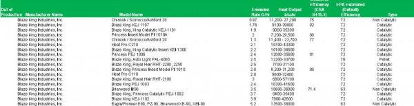

    Here's the numbers from the EPA website for the Progress Hybrid (Firebox: 2.8 Cu.ft.):
    EmissionRate G/H: 1.33
    Heat Output btu/hr: 12,538 - 73,171
    Actual Measured Efficiency: 81
    And according to the blog today, for the Union/Steel Hybrid (Firebox 3.2 Cu.Ft.):
    EmissionRate G/H: 1.2 gm/hr
    Heat Output btu/hr: 13,241 to 60,145
    Actual Measured Efficiency: over 82%
    On their website they rate the Progress Hybrid as Max Heat Output: 80,000 BTUs /hr.
    Wonder what that number will be for the Union/Steel Hybrid?
    For comparison from the EPA list (I have no idea whether these are apples to oranges comparisons):
