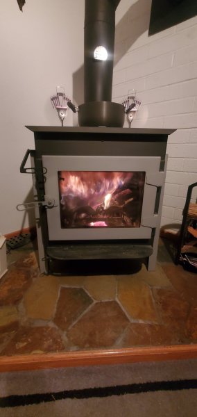

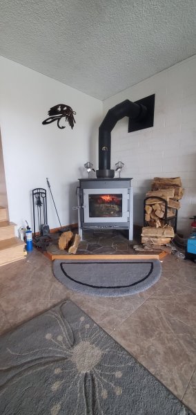

    I've had my IS since 2015 and love it. It's currently chugging away as I type keeping the house nice and warm. I live in Northern Nevada and am 2800 miles from their factory but that didn't stop me from ordering one. Their customer service is second to none, the best in the industry in my opinion.
    They took my stove back after 6 years for a design flaw which caused the earlier stoves to suffer a tear in the steel above the door hinge. Shipped it 5600 miles round trip on their dime, fixed the stove with the repair and made the stove that much better, and added upgraded parts all at no cost to me...!!! Thousands of dollars in shipping and repair and Woodstock didn't let me pay a dime for any of it. Superb business and product. 20221127_184430.jpg 20221204_113351.jpg
    Stephiedoll, Chvymn99, Danno and 8 others like this.
