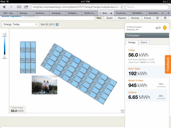

    The house is easy to heat and we would heat with the stove most of the time but we do have a good system to fall back on, goal is zero bills and that will be easy to obtain for us we just have to get rid of 4 months of heating as the rest is taken care of with geothermal and solar system.

    We have a generator that is good and is dependable 7000 watts and a manual transfer switch, and the geothermal with a soft starter we wanted a stove or fireplace for our basement room project, my wife grew up with only wood heat and loves fireplaces so I came up with the idea of heating with wood efficiently and having a backup for a month long winter power outage is now a need after we survived 3 weeks with an outage a few years back.
