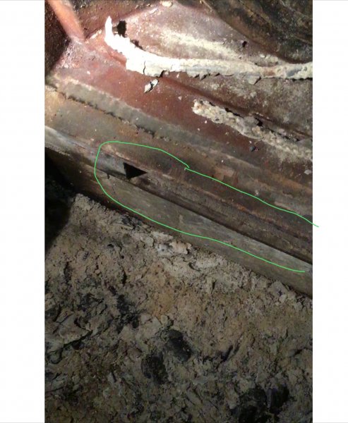

    I’m confused as to which gasket this is. ? Are they having you unbolt the air control on the rear of the stove and replace the gasket where the secondary air enters?
  10. VCSplitter
    VCSplitter
    Oct 31, 2019
    8
    2
    Rockland Co, NY
    Yes, I'll have to unbolt the air intake assy and replace a gasket inside.
  11. Flamestead
    Flamestead
    Dec 7, 2013
    2,167
    10,974
    Windsor County, VT
    Ok, not too bad of a job.

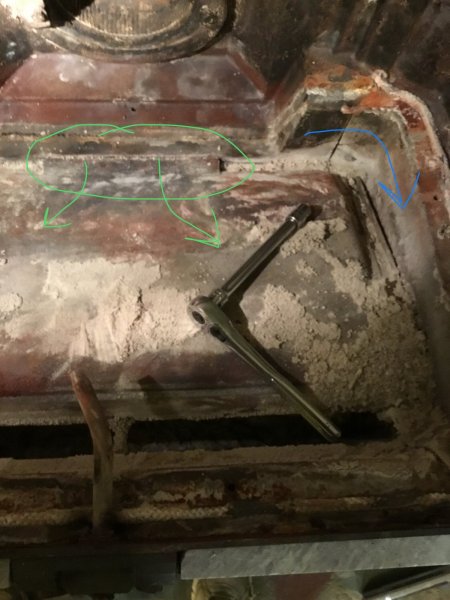

    The green circle in the first pic is where the gasket is (in the inset part).
    Green is secondary airflow, and the blue is primary. You won’t be seeing it from the top, like in the second picture, but gives you a sense of how the top of the firebox connects to (through) the back of the stove.
    Note in the second pic where the green arrow lines start. That is the seam you will be gasketing from the backside.
    VCSplitter likes this.
  12. Flamestead
    Flamestead
    Dec 7, 2013
    2,167
    10,974
    Windsor County, VT
    Looking down into the stove with all the internals out. The area I’ve circled is the hole where the secondary air comes in. Sorry I don’t have a better picture.
