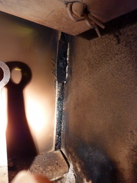

  6. BrowningBAR
    BrowningBAR
    Oct 14, 2013
    1,379
    2,105
    San Tan Valley, AZ

  9. Woody Stover
    Woody Stover
    1,261
    3,046
    Southern IN
    Having a hard time seeing what's going on in that pic, but that cat frame looks roasted. Moot point anyway, OP is an Indiana Hoser. :)
    As for the Keystone, I would go 1K+ if it was in great shape. Look around the bypass frame and cast iron cat scoop for warpage...but I think the scoop pretty easy to warp, I wouldn't be scared off by that. Low-ball him in that case.Warped bypass frame may be more serious. Look for white spots next to the seams, which indicate air leaks. Ask if he got it new, and if he's done any maintenance. Try to get a feel of weather he knows how to run a stove properly (ask how he proceeds from a cold start.)
