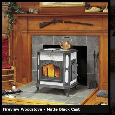

    I found this in Woodstock's stove gallery photos:
    No way does that look like 30" clearance from any angle above the stovetop.
  5. Woody Stover
    Woody Stover
    1,261
    3,046
    Southern IN
    What you can't see is that the mantel is solid cement. ;)

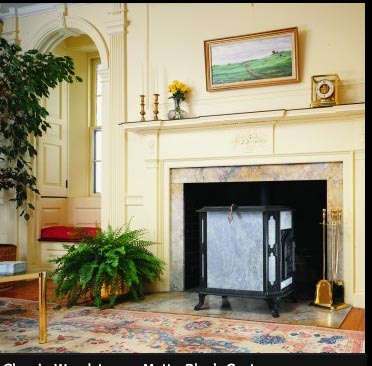

  6. fire_man
    fire_man
    Dec 5, 2013
    282
    689
    North East MA
    This one too??

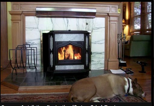

    The shield can be on the mantle. I found this one in the "owner gallery" WS photos that I like. I just wonder if it meets clearance code?

    Might be tuff to attach a shield to the stove to protect areas above the stove. They do come with rear shield that helps rear clearances.
    I contacted WS and it turns out the photos unfortunately were for advertising purposes, and do not necessarily represent "code" installations.
    I saw some owner installed setups that had me scratching my head, knowing the heat the Progress throws out I would be worried for some owners.

    How about a heat shield that can be screwed to the underside of the lintel with sheet metal screws and protrude out over the stove top? It would have to stick out a bit I imagine. I also wonder if the stove is partially in the fireplace opening, would the shield not have to be as big?

    The stove would have to be out at least 6" from the fireplace opening for me to be able to get to the "T" and also to meet rear clearance to the side wood trim.
    The Lintel mounted shield is interesting - I might run that by WS. I like it because It would be less obtrusive than a mantel mounted shield. Thanks for the tip Fishingpol! I think I will have to have a sit-down with the town inspector and run all this by him before I move forward. I would hate to get to the finish line and not cross it.
