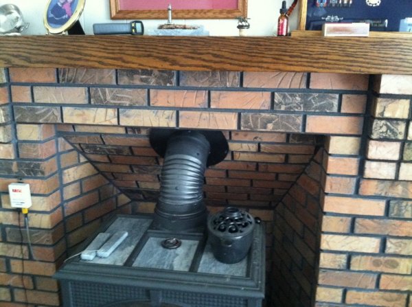

    21" :eek: But the way my new hearth was built I think it creates a good air flow around the stove and helps cool the mantle. image.jpg

    Todd
    I'm a little slow here, how the heck do you load that stove?
    Are you saying you only have 21" from top of stove to bottom of mantle board? The stove sits so far inside the cavity its hard to figure out how that impacts the necessary clearances.

    Keystone is 28" tall.
    Lintel is 29" from floor
    Shelf lower surface is 51" from floor
    Bottom edge of horizontal mantel board is 38" from floor
    So there is only 10" of mantel clearance from stove top to lower edge of board. It would be easy to add a shield below the board to protect the bottom 3/4" thick edge which protrudes from the wall, but it's the 13" wide board itself I am worried about.

    The loading door swings out 90 degrees before it hits the brick so there's no problem loading.
    Yes, only 21" from stove top to the bottom of the mantle. With the old fireplace there was no way I could keep my hand on that mantle but now it's just warm even with a 700 stove top.
