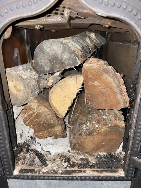

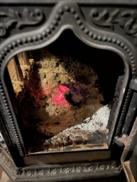

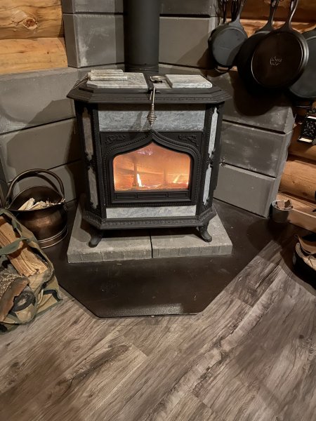

    Just had my first 24 hour burn in my rebuilt Fireview. 23 lb load of Aspen/Oak with the air set just about closed at 0. Of coarse the stove wasn’t making any heat and was just warm to the touch at 100 degree stove top but it was nice to see a few good chunks of coals to relight this evenings fire.

    The Fireview is perfect for a 12 hour reload schedule where you don’t have to worry about cold starts. Mine is sized just about right for my place where I should be able to go with that loading schedule most of the winter.
