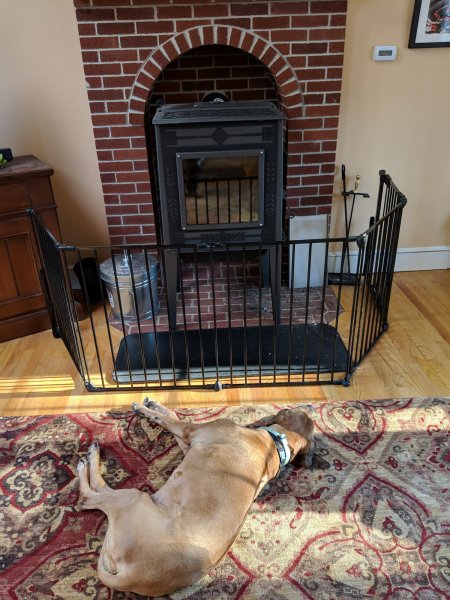

    Something changed last night, and I'm not sure if it was cooler, drier air outside, or maybe that I've crossed some "break-in time" threshold, but my small load of only Canawick bricks ignited and got the temperature rising a lot faster than before. Within about 30 minutes, I was able to close the door and bypass, dial the air down to .75, and the cat was off and running until it burned down to ash and a few small coals.
    This morning I loaded up a few more Canawick bricks on top of the coals and topped those with a bunch of thick splits of my under-seasoned firewood, and the STT and pipe temps quickly shot above 500 (as hot as I've seen them yet!), even as I could hear the moisture hissing out of the splits. After closing the door and letting the roaring fire drive some more moisture out of the splits, I closed the bypass, dialed the air down to 3, and then .75 a few minutes later, and it's been smooth sailing since then!
    Would a drop from 30s and wet to 20s and dry weather make this much difference? Or is there some validity to my break-in idea? Either way, it's like night and day, even with less than optimal wood. And the dog approves! :thumbs:

    Only point on the break-in idea, is that the cats can be hyperactive when new. And after a little while burning they can settle in. I think the temperature drop has more of a point as it probably in creased your draft.
